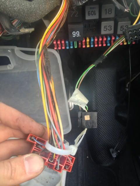

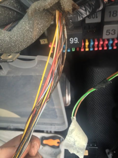

ben_wooduk 0 Posted November 11, 2012 Removed my dashboard today to replace with a shiney new one and rather alarmingly i was greeted with this. Am i right in thinking i'm lucky this hasnt caused a fire? The brown wire has melted quite far up too. So the first thing on my list is the DIY mod to put a fuse on this wire but the whole wire is pretty shot! Does anyone know how to replace the whole wire from the block connector? Is it a matter of brute force to pull the wire from the block and replace or do i need *to buy something? Bit of a dumb question i know but i dont want to yank on it if there is a certain way it is removed.* And what do people replace the gray sponge around he wires with, mine is litterally falling to pieces!!! Quote Share this post Link to post Share on other sites
dumptyboy 0 Posted November 11, 2012 I replaced the whole dash wiring loom on my VR recently and had to remove a few of the cables from the connectors as I didnt want to just botch them. I used two large paper clips and pushed them in from the pin side of the connector to remove the cable, you should see two small notches where the paper clips need to be located, if you straighten the paper clips and push them as hard as you can into the slots then the cable should just pull out fairly easily. Once you have managed to get one cable out the rest becomes obvious. I would personally see if you can find a replacement section of loom first and possibly just replace this section from the fuseboard to whatever its controlling. Pm me if you want more details on how to remove the pins succesfully. There is also a tool designed for removing them but its not cheap. Rob. Quote Share this post Link to post Share on other sites

ben_wooduk 0 Posted November 11, 2012 dumptyboy said: I replaced the whole dash wiring loom on my VR recently and had to remove a few of the cables from the connectors as I didnt want to just botch them. I used two large paper clips and pushed them in from the pin side of the connector to remove the cable, you should see two small notches where the paper clips need to be located, if you straighten the paper clips and push them as hard as you can into the slots then the cable should just pull out fairly easily. Once you have managed to get one cable out the rest becomes obvious. I would personally see if you can find a replacement section of loom first and possibly just replace this section from the fuseboard to whatever its controlling. Pm me if you want more details on how to remove the pins succesfully. There is also a tool designed for removing them but its not cheap. Rob. Cheers mate, when you say not cheap, how much we talking? Do you know what the tool is called? I only ask as I am making my own head light loom also so could come handy, my wallet likes the paper clip idea though :) Never thought about replacing it, I have a spare from the Rado we are breaking so that wouldn't be an issue. Do you recommend this because its easier or because there could be other issues? Cheers for your help mate, much appreciated. ---------- Post added at 5:43 PM ---------- Previous post was at 5:38 PM ---------- Dox said: Wear gloves when handling burnt wiring insulation, nasty stuff, it can lead to amputation if it gets under the skin. So dont use my teeth then :lol: Quote Share this post Link to post Share on other sites

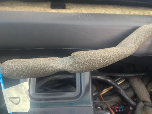

ben_wooduk 0 Posted November 12, 2012 Anyone replaced the gray wiring sleeve? There is nothing left of it and i'm considering using so much felt i'll double the weight of the car! Quote Share this post Link to post Share on other sites
yacobwood 0 Posted November 12, 2012 ive found a couple of different products that would prob do the job but nothing similer to the standard foam stuff http://www.vehicle-wiring-products.eu/VWP-onlinestore/sleeving/heatshrink.php#adhesive http://www.vehicle-wiring-products.eu/VWP-onlinestore/sleeving/sleeving.php#twistwrap Quote Share this post Link to post Share on other sites
ben_wooduk 0 Posted November 12, 2012 I like the first one but I cant get it on the loom without detaching the complete loom! I think the best bet is to wrap it in the VAG fabric tape (the stuff found under the bonnet) but i'm worried it may cause more rattles with no foam :( Take your Audi to pieces and tell me what they use 18 years later :lol: Quote Share this post Link to post Share on other sites
yacobwood 0 Posted November 12, 2012 ben_wooduk said: I like the first one but I cant get it on the loom without detaching the complete loom! I think the best bet is to wrap it in the VAG fabric tape (the stuff found under the bonnet) but i'm worried it may cause more rattles with no foam :( Take your Audi to pieces and tell me what they use 18 years later :lol: They use the tape........100%........no need to take anything apart........ :( Quote Share this post Link to post Share on other sites
