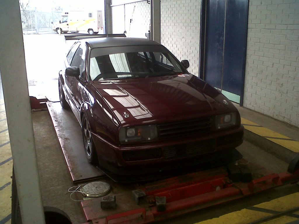

HumumuH 10 Posted January 2, 2012 Hi all, Previous owner of 2 x VR6's coming back to the Corrado fold. This time's a bit diffrent though as I've bought this car to race in. Plan is to compete in the 2012 SMRC Saloons and Sports. Car's just about ready for it's first test where we'll suss it out and make further changes/mods from there. Hoping some of you guys can help us with your knowledge as it's all new territory for us! Biggest challenge so far has been getting it on and off the trailer as the front splitter sits 1.5cm off the ground lol! Cheers. Quote Share this post Link to post Share on other sites

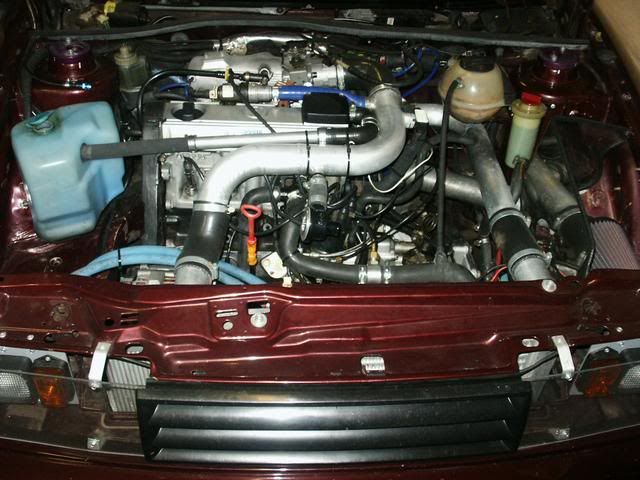

Alex_G60_Fanatic 0 Posted January 27, 2012 Nice... What is it btw? G60 turbo? looks like an interesting engine bay set up. Quote Share this post Link to post Share on other sites
HummuH 10 Posted January 27, 2012 Yeah, G60 Turbo. I can't take any credit for it though, was all done by JabbaSport before I bought it. It's bored out to 1.9 and running an IHI VF23 Turbo, JabbaSport downpipe with PipeWerx decat-back exhaust system. Many other mods too including Scat 144mm H-Beam Rods, Schrick baffled sump, JE forged pistons and the head is ported and gasflowed with 1mm larger inlet valves, custom piper camshaft and vernier pulley. Intercooler and radiator package was custom made. I'm told its putting out c. 310bhp but I've yet to have any sort of dyno done so will be sceptical on the output until then. First test in the car is next week at Knockhill (weather permitting!) so idea is to give it a test run and take it from there. Can't wait to get out in it! Quote Share this post Link to post Share on other sites
elliott 10 Posted January 27, 2012 Interesting car, what's with the front light set up? Might need to take a run up to knockhill now, love to get some pictures of a racing C! Quote Share this post Link to post Share on other sites
HummuH 10 Posted January 27, 2012 Interesting car, what's with the front light set up? Might need to take a run up to knockhill now, love to get some pictures of a racing C! I hope so. It's all still very new to me. Headlamps are out to accommodate intercooler, radiator and oil coolers. Custom made arrangements in its place with two headlights and indicators. Feel free to say hi if you pop up to Knockhill. Will post up the dates when I know the car is fit to race and passes scrutineering for the series. Quote Share this post Link to post Share on other sites
VW_OwneR_85 2 Posted January 27, 2012 hi welcome back. in regards to your front spoiler hitting the trailer, im sure you can make some sort of quick release system where you can easliy remove and fit it, wing nut bolts maybe? Quote Share this post Link to post Share on other sites
HummuH 10 Posted January 27, 2012 hi welcome back. in regards to your front spoiler hitting the trailer, im sure you can make some sort of quick release system where you can easliy remove and fit it, wing nut bolts maybe? Cheers. Got a new trailer now so no issues. Splitter is part of a flat single piece underside. Doesn't run the full length but a good way up the car. Quote Share this post Link to post Share on other sites
