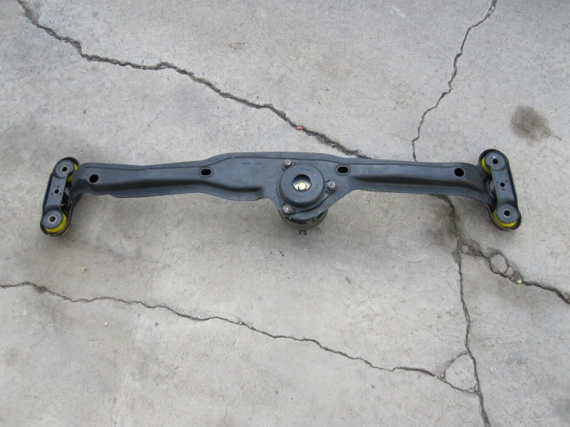

am I supposed to also remove the 3 nuts on the bottom to take out the rubber ring and metal insert that the mount attaches to in the front subframe? I'm trying to undo them upsaide down but the nuts are just getting damaged.
see the centre of this pic I found on google: http://i28.photobucket.com/albums/c240/g60mikey/transformer098.jpg
Since i've got the engine jacked now, it seems easy enough to drop out the 4 retaining bolts holding the lower front subframe. My god they're not about to budge!!! Any advice? If i'm servicing the front engine mount and fitting a super hard VT mount, will it be important to service or replace the 4 subframe bushes and the subframe lower engine mount insert?

I just removed the lower mount cover 3 bolts, once the vibra one is fitted i dont think you need to re fit the cover as the vibra one sits on the cross member only.
But i re-fitted the cover anyway.
The bushes will probably be ok but if its off the road for a while nothing stopping you if it isn't a daily, they are easy to do with the right tool so if you get stuck if you decide to do them give me a shout for some how to pics ;)

I've had a bit of a hard time trying to undo the 13mm nuts on the cover under the front engine mount. 2 ok, 1 starting to round off with my Halfords 12point sockets. I shall go and acquire some proper hex or impact sockets and try again before I trash the nut completely..
i've also been trying to take off the lower front cross member (i was refering to this as the lower front subframe earlier - now corrected!). However i'm having a similar problem with one bolt that won't budge, so i'll try a proper 17mm hex socket on this too.
from a thread I stumbled upon on the VR6OC forum, it may not be worthwhile bothering with fitting 4 powerflex / pu bushes to the cross member. Who's got an opinion on this? genuine rubber vs old rubber vs new pattern rubber vs pu.

stick with standard rubber ones chris, regarding the old mount on the lower section is actually needed as part of the front mount but the vibratechnics one doesn't
so you remove it.
Yeah get proper hex rather than multi point, you may need a fair bit of torque to get the bumper bolts out but if you have one next to the stuck one out then squirt plenty of wd40 in there through the adjacent bolt hole and leave over night. You really dont want the bolt to sheer off as it could be a right pain to sort.
not the end of the world if the 3rd nut snaps off as it isnt needed anyway, just refitting the cover at the bottom once the vt is fitted tidies it up underneath.
Bumper bolt torque is 85nm as per Bentley manual
