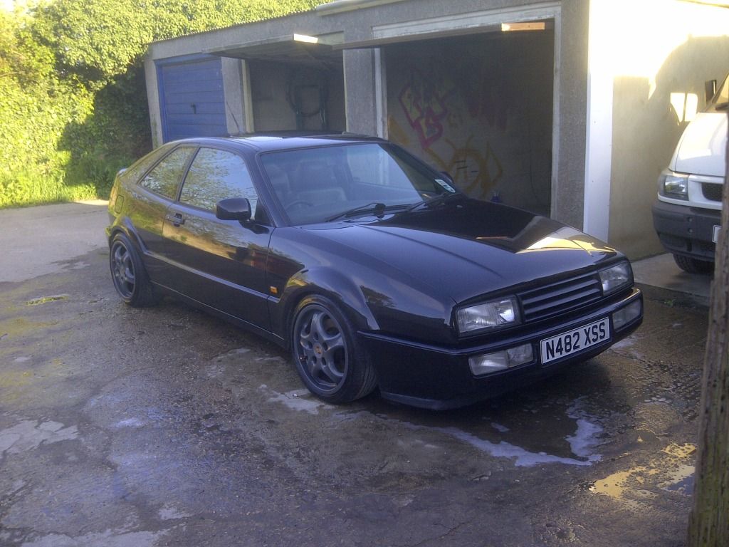

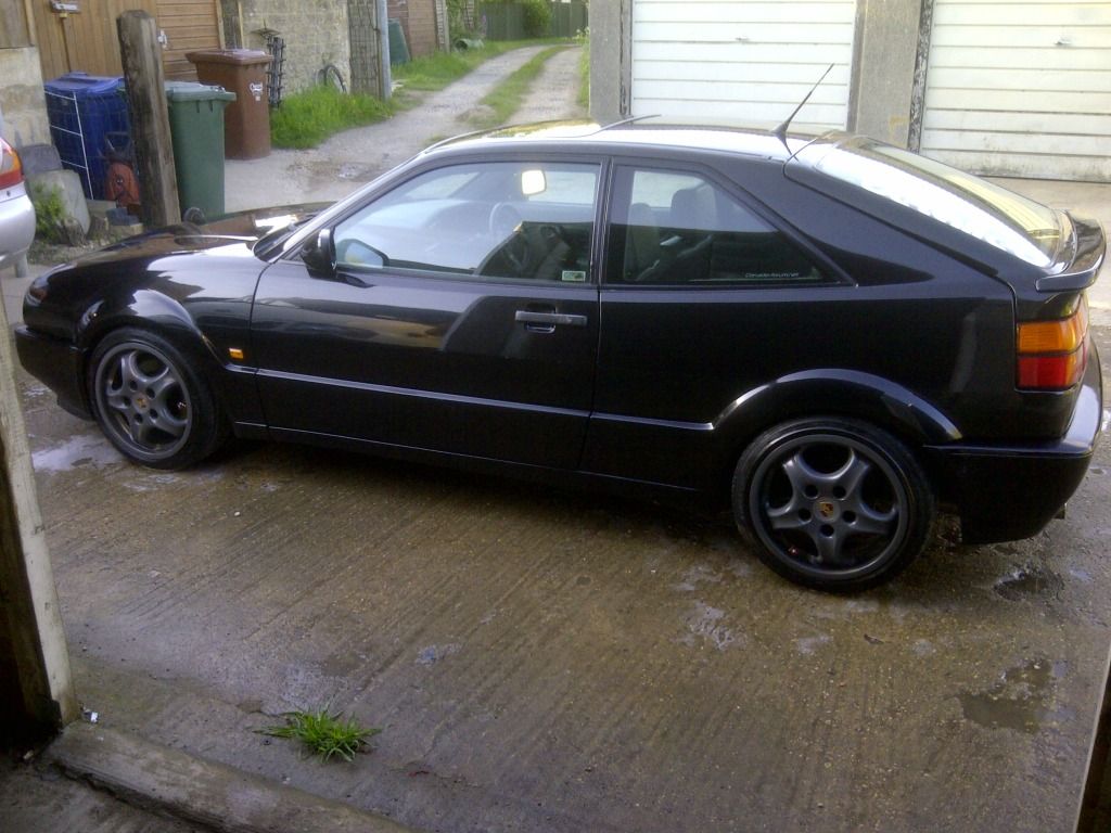

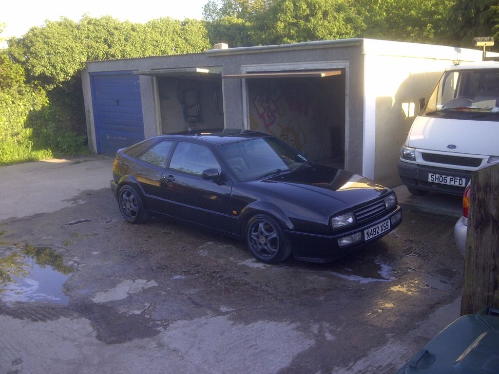

Im running Staggered Porsche Cups @ 7J x 50et on the front & 9J x 70et at the rear, on 40mm spacers/ adaptors going from 5x100 pcd to 5x130. put few pics from the other day below.....
IMO the fitment is better than i could of imagined, sit plush all round with a great "PHAT" look at the rear, had to stretch the tyres somewhat on the back to they dont scrape but thats only due to my choice of ride height. Overall in my eyes i got achieved perfect fitment.
