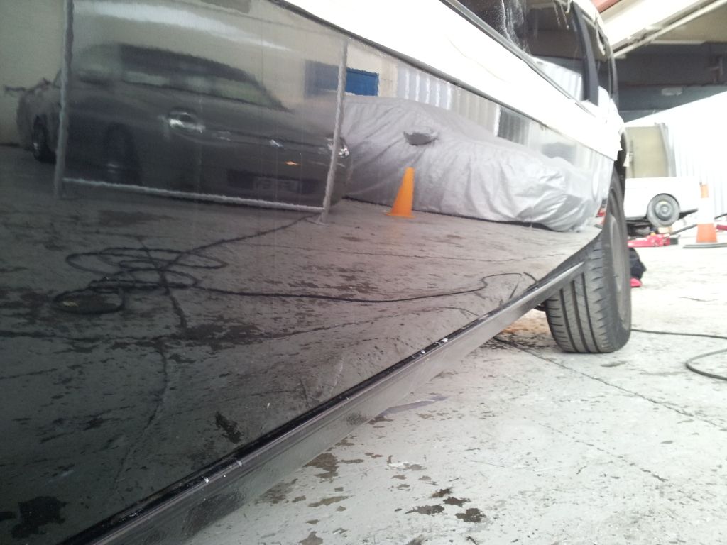

The car still needs refining, sealing and waxing plus the plastics need doing.
Started off with a 2BW (no way to get to water supply for my snow foam) with grit guards (megs mitt and muc off),
de-tar using tardis,
clay bar using Bilt Hamber,
used PD8 (paint depth gauge),
machined some areas using megs 83 and hex logic and makita 9227c,
used megs 83 with Megs G220v2 (mainly my helper using this),
used 3m wet n dry to wet sand areas + fast cut with 3m pads
buffed off using Autoglym microfibre's

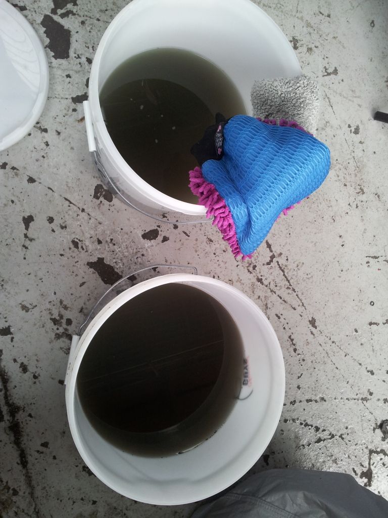

Look at the colour of the water in the buckets,

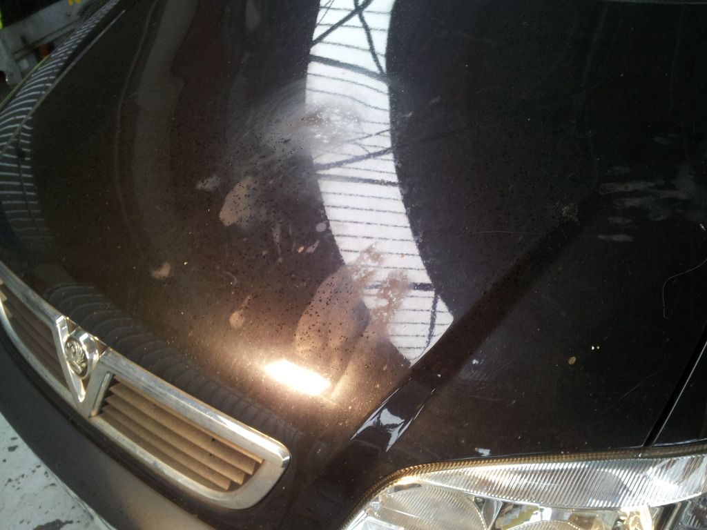

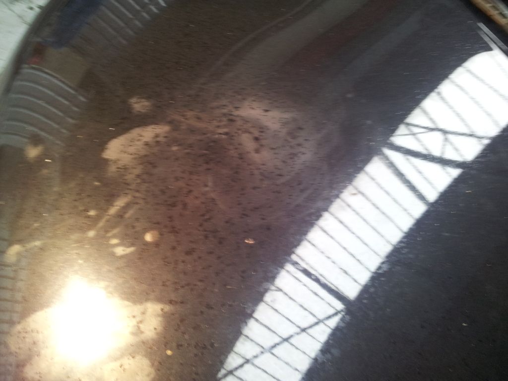

Here is the bonnet, check out the paint hand prints!

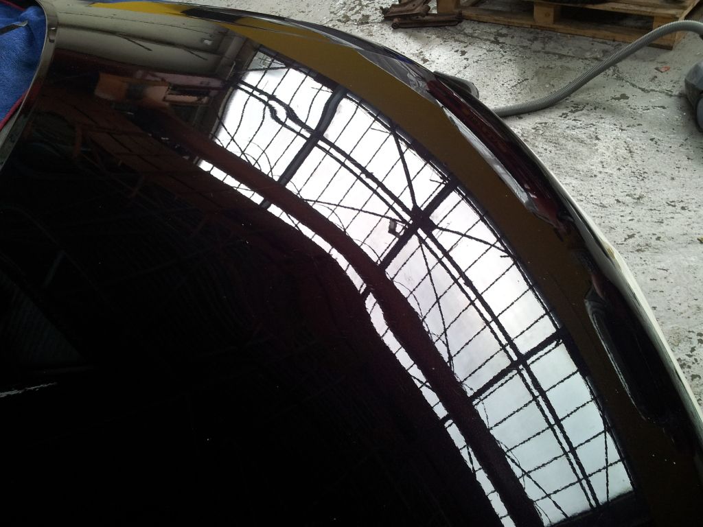

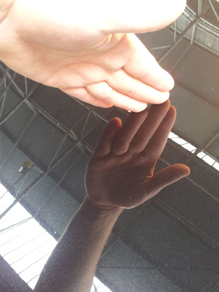

Here are some of the after pics of the bonnet,

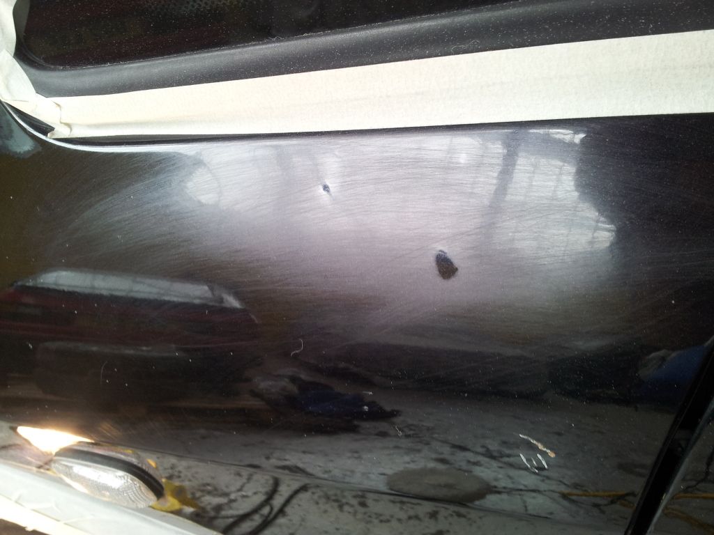

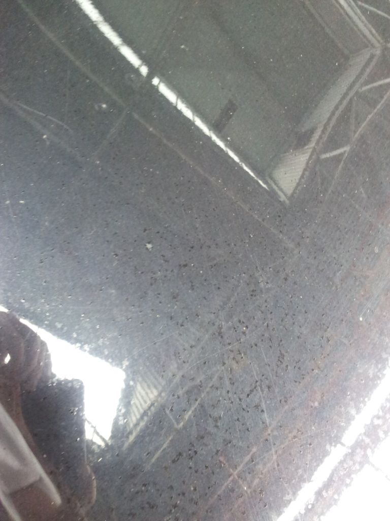

Here is another of the bad areas, the wing! Been washed with a brick I think.

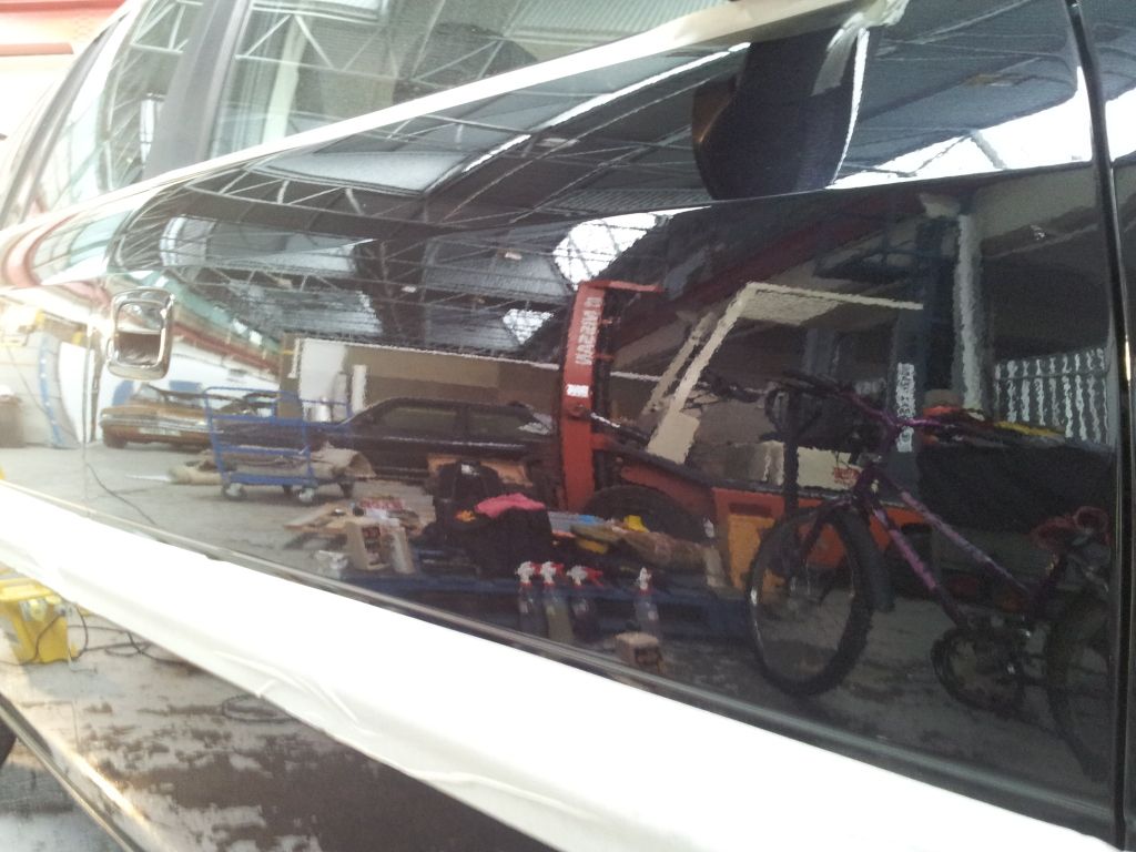

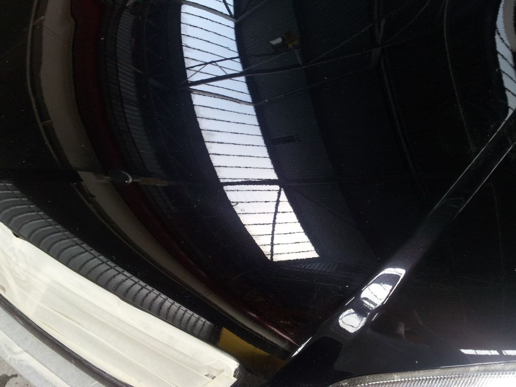

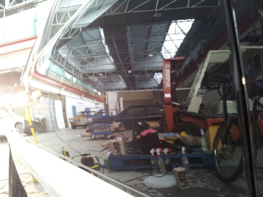

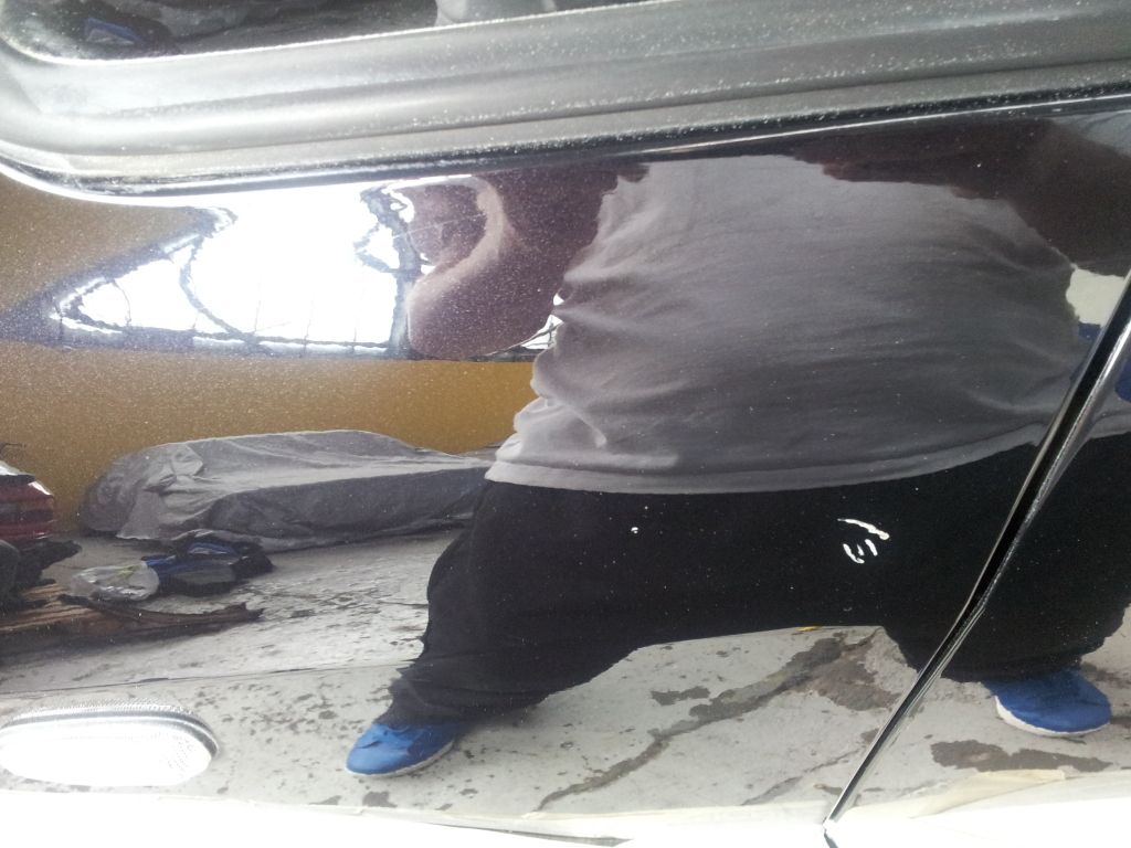

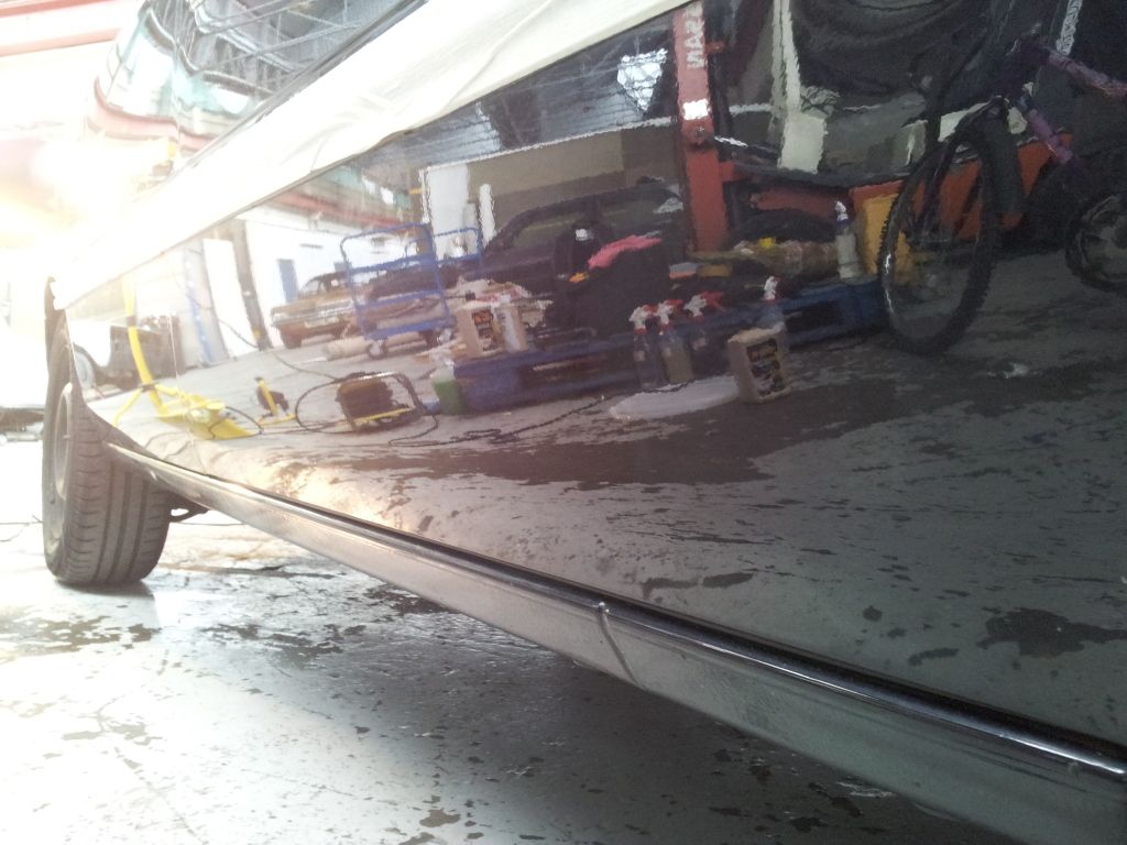

Some side shots,
