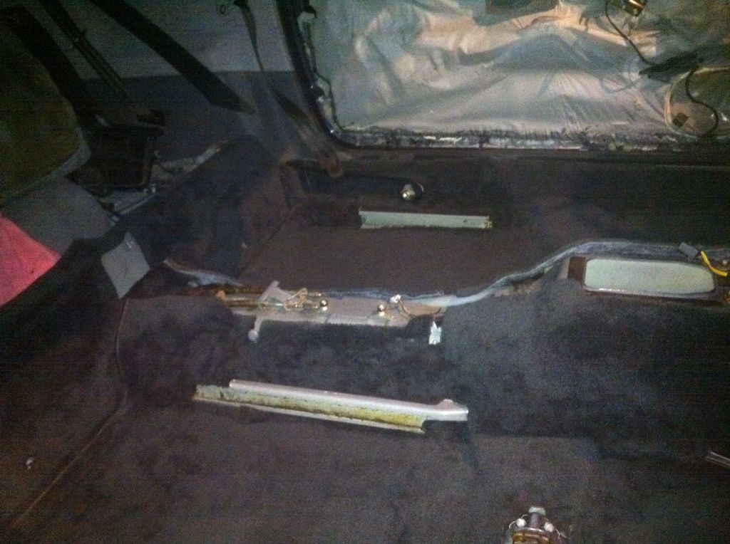

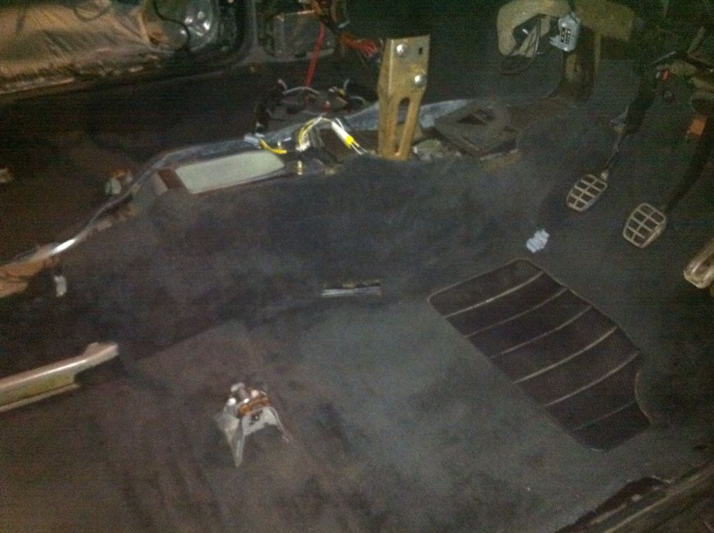

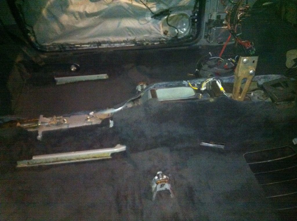

Having recently done this I'd say removing them is pretty easy.
There's loads of info on here on how to remove the centre tunnel, handbrake handle etc.
Front seats, dash undertrays, footwell trim, rear bench will also need to come out which are all easy enough.
Just make sure you keep a note of where all the trim and clips go... I used freezer bags and took photos... amazing the stuff you think you wont forget but do! And more than likely some will be missing or will break so good plan to make a list of needed replacements.
Make sure you've got a good day of weather. Took me most of the day to remove everything, clean, leave to dry and put back in.
If you're looking to change colour, I'd wait and do it when you have the carpet... like I said, not a technically difficult job but time consuming!

Not too bad. Time consuming. Loads of clips and tabs and screws everywhere, especially around the drivers side footwell. Obviously all the center console will have to come out. I just done mine but as I'm doing a dash and airbox conversion with everything out I had easy access to everything.
