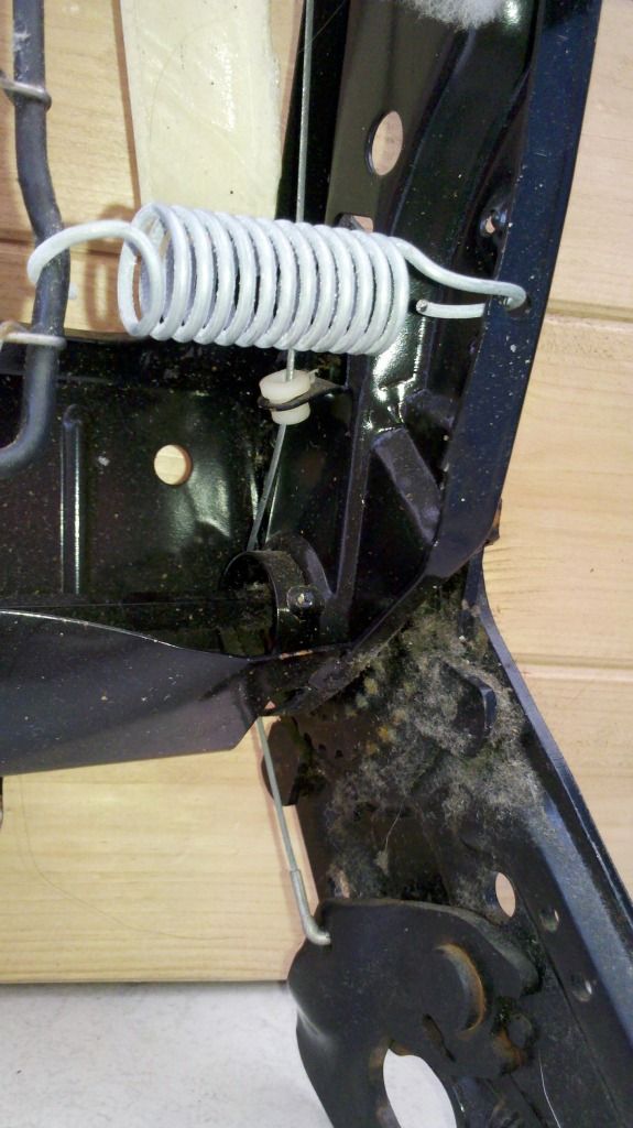

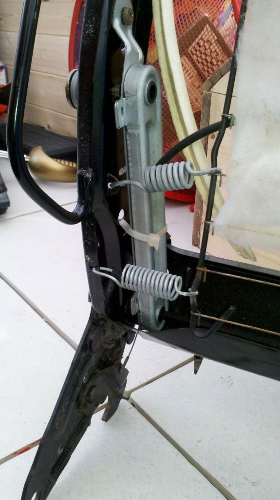

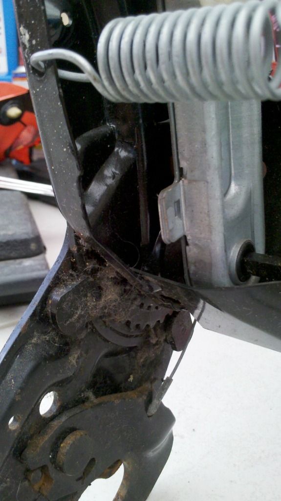

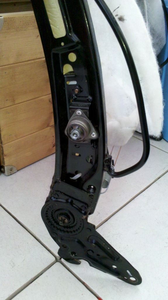

Ive taken a few pictures but I only have my phone camera at the moment so they are not to clear im sorry:
Excuse the mess on the cogs,haha.
Im not sure if they will help you, but hopefully it gives you a better idea of what the set up is.
---------- Post added at 12:24 PM ---------- Previous post was at 12:06 PM ----------
Also having looked at the mechanism again, i used a spanner to simulate the seat mechanism reclining, and it looks like the cog looking things in the picture do nothing and the part that moves the seat is inside this area but I cant make out how it work exactly?? So cleaning any muck off wont make any difference to fixing the problem! I think you might be right and the internal cog might be missing teeth?
