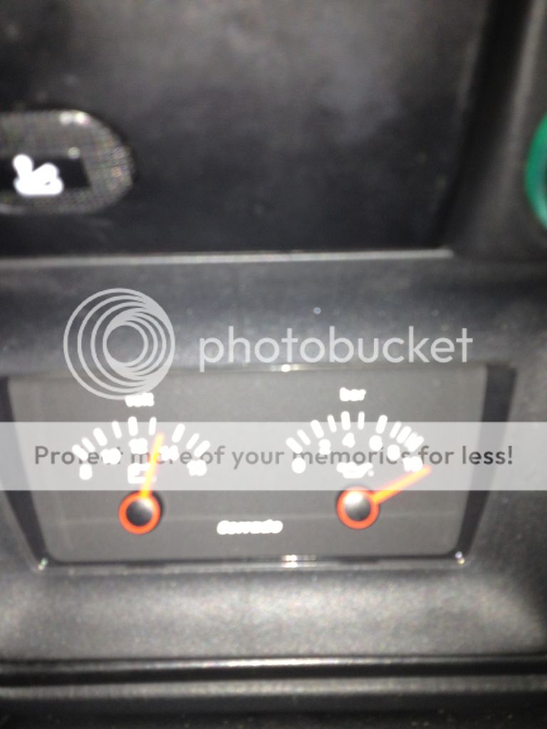

Wesleyvr6 10 Posted October 20, 2012 Hi all, I have just fitted my new video gauges but not sure if the wires n the sender are the right way round, there are 2 symbols on the sender one is 'G' and the other is 'WK'. I have the wire form the vdo gauges to G and the original blue wire in the bay onto the WK one. The reason I'm not sure there the right way round is because when I start the car the oil pressure shoots to over 10 on the gauges! Is this correct? Thanks Quote Share this post Link to post Share on other sites

Wesleyvr6 10 Posted October 20, 2012 Update, I have checked the oil and took the car for a test drive, as soon as you start to slow down the oil light on the dash starts to flash.i don't understand what the problem can be as all was fine earlier today before I swapped the pressure sender? This is what the Vdo shows all the time whilst driving Quote Share this post Link to post Share on other sites

Wesleyvr6 10 Posted October 22, 2012 Thanks all, think I've got to the bottom of it, basically the sender I've been supplied has a low pressure reading of 29.6psi which is very high, hence why the light is flashing on the dash! Quote Share this post Link to post Share on other sites
