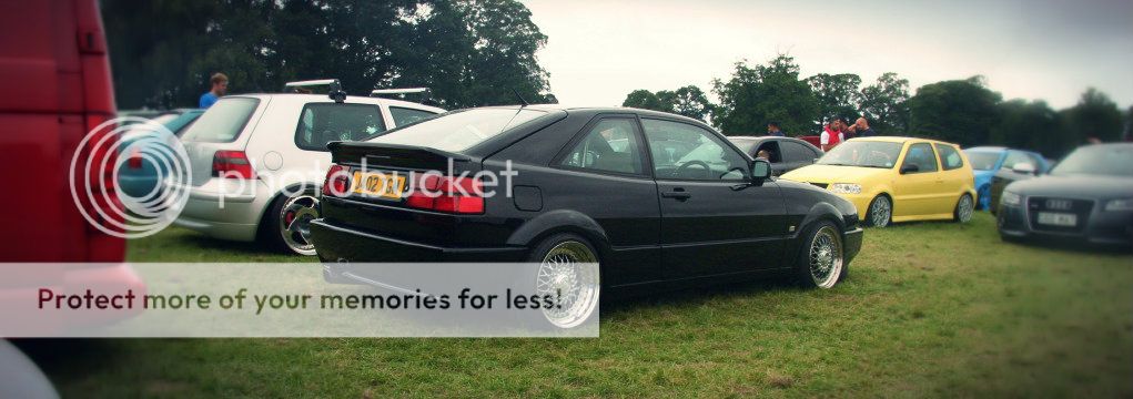

Here you go mate,spec wise see below.
BBS RS 158 5x130 with adaptors
Front: 8x16 lip 1.5
Rear: 8.5x16 lip 2.5
Now those look sweet indeed mate I like those BBS wheels are those the 16 inch BBS RS wheels? Because i don"t see the BBS cap in the middle. It's ok if there not.
Also what does 8x16 in the front mean? and 8.5 x 16 on the Rear mean? and whats 158 5x130 mean is that your wheel adapter size? Im sorry for all these questions i have to ask because i need to get this done right when i upgrade Also does that Rub at all? Is 2.5 on the rear the widest you can go with out rubbing?
