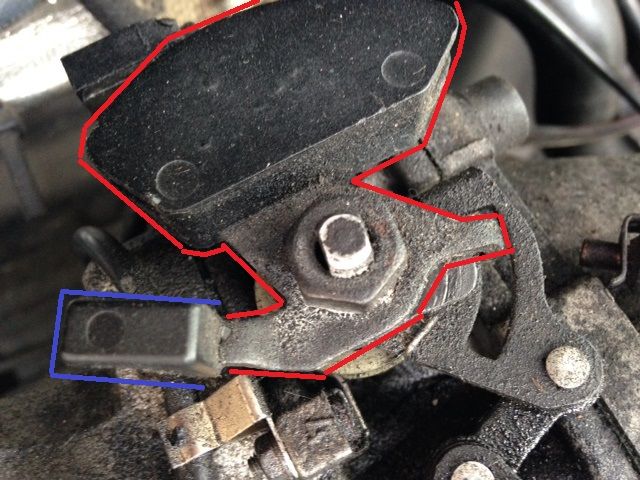

Got a picture of the offending part.
Can see it's snapped where I have highlighted in blue.
I am guessing this might be a G60 only part???

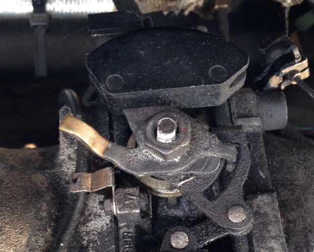

I just tried to crack the throttle with my hand and the other half of the plastic bit that has broken fell off in my hands. haha
this is what it looks like now :p
hi , never actually seen these throttle bodys so im not 100% sure if this is possible but maybe take your old throttle body to some one that can weld a nice piece of metal maybe a nut with a cut/slice down the middle so the cable can slot into that way it cant go anywhere? dunno but if they break that easy look at modifying the one you have,
