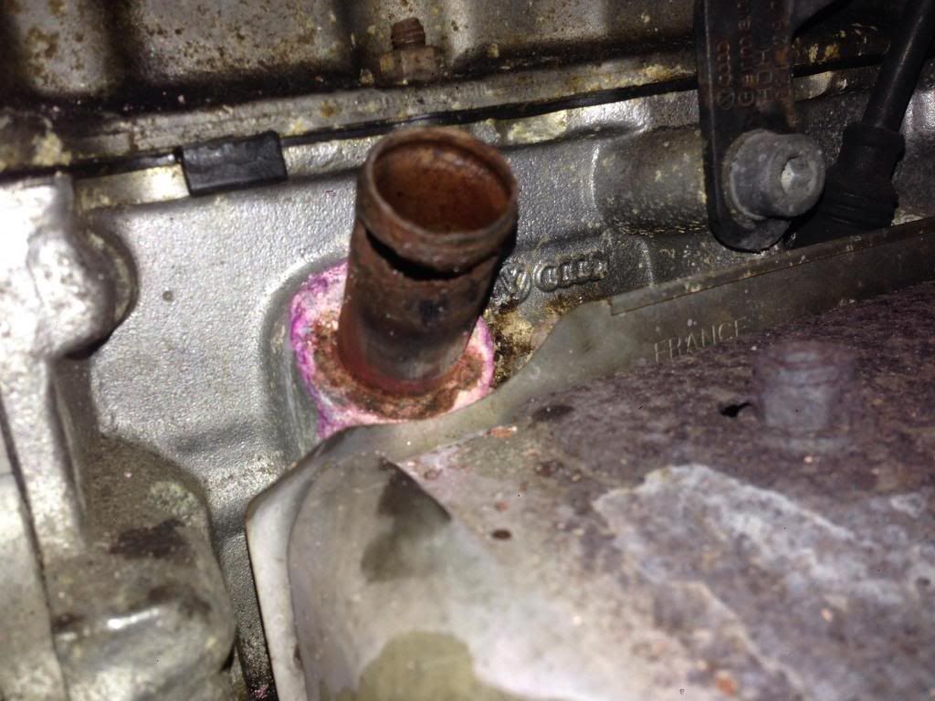

First one is the old brittle coolant pipes and after a 100+ mile an hour long run blast i obviously had a coolant leak, and discovered this
The metal insert that goes into the head which the heater matrix coolant pipe clamps over has rusted through halfway round under the flange section, has anybody had this? my mate says either cut it off or just stick two clamps over the pipe?

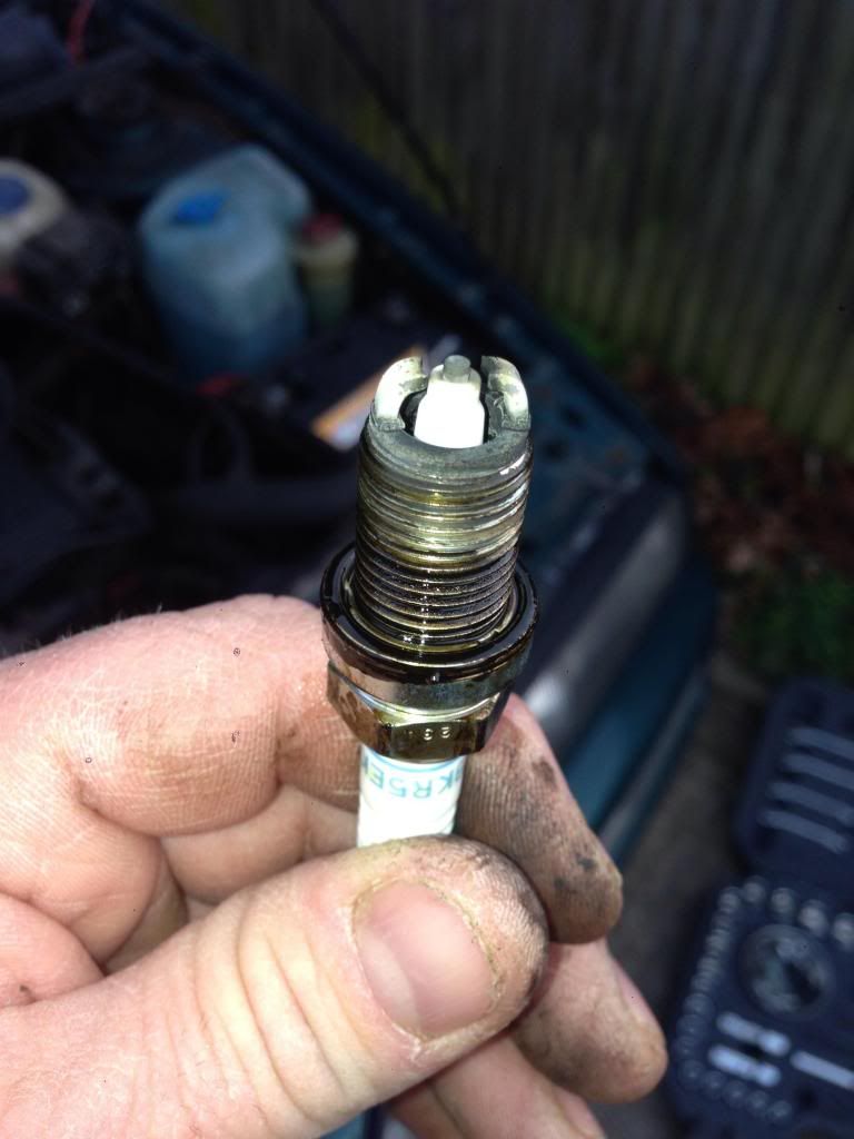

Also checked the plugs in 1 and 6 cylinders and found them to be spot on with greyish deposits, nice to know!

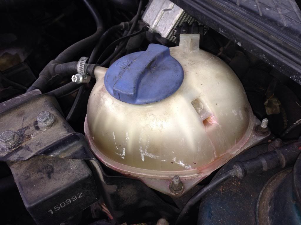

Also does anybody know if i have the right header tank on my vr as coolant was pushed out of the side a shown in the picture below today??

Couldn't find any splits in the matrix hose but the clips were pretty loose on the head end so just put it all back together. Bled the system ran up to temp and fans cut in fine. Took the car for a spirited drive and noticed a little bit of coolant had been released from the overflow on the side of the expansion tank? Temps were good on the dash but i did notice that i had no coolant coming out of the return pipe which leads back to the expansion bottle when bleeding the system.

Doubt theres much you can do about the rusty pipe other than welding it up tbh. If you use the proper spring clip down quite low it should seal properly though. The expansion tank looks correct, and the overflow problem could be just that it needs bleeding a bit more. Run it up with the cap off, and massage the hoses to release any trapped air. Other than that, the overpressure valve in the cap could have gone (blue ones are the better one, and are replacements for the old black one which is notorious for this problem), or the tank itself is blocked. Those are the cheap and easy fixes anyway. Your temps both water and oil look good to me. The coolant should sit bang on 90 pretty much at all times so that looks good. Oil good without being too hot, so I'd say its all pretty good in that respect.

Bought a new blue expansion cap today from tps, fingers crossed has cured the coolant leaking from the side of the header tank. Also water temps looked better on the gauge:-)
