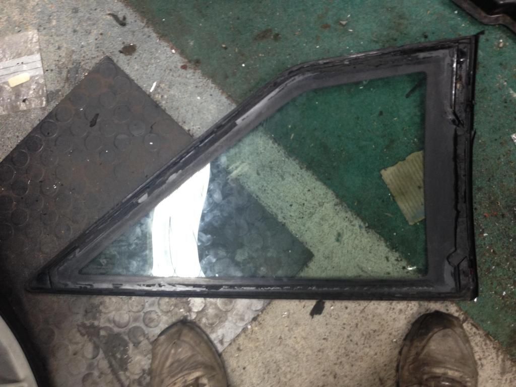

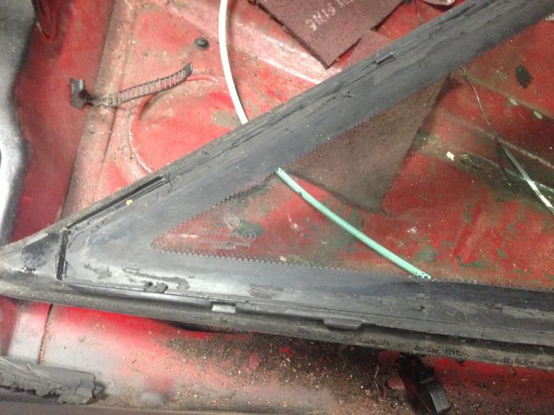

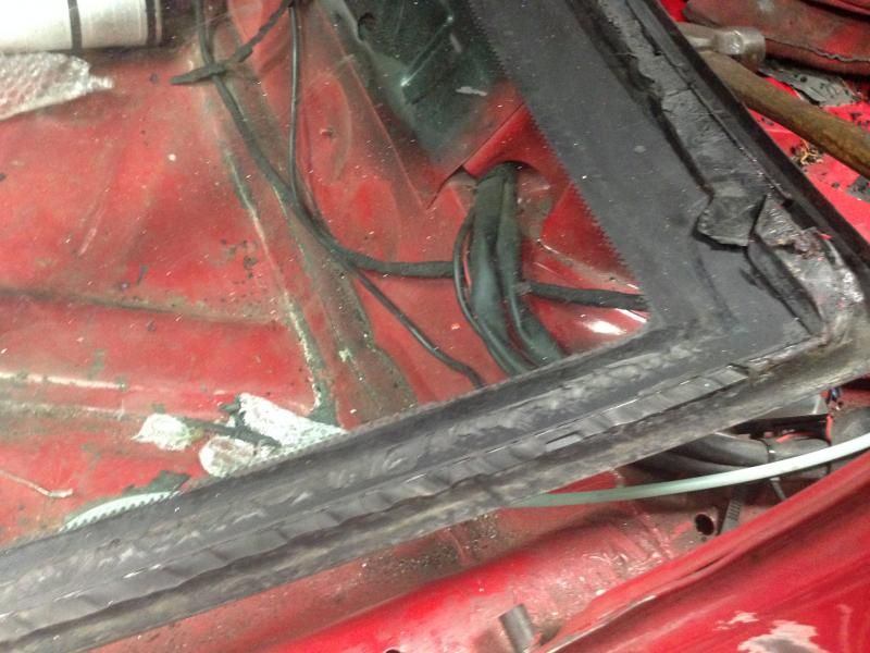

I removed one of the rear windows today and I would like to know what peoples opinion on re-using it is?
Have I cut of the rubber on the inside or does the glass bond to the metal?
Edited by rado20vT
IMO if you haven't cut/damaged the rubber finishing seal around the perimeter then it will be fine to bond back in with windscreen adhesive as that's what actually makes it weather proof ,
I've done it a few times, just try and get the old sealant as flat as possible
and clean off the old sealant from around the aperture on the car's frame, then prime the
metal using the primer contained within the kit.
Be very carefull to make sure that the gap is correct between the door seal edge and edge of the window 'cos if you
get it wrong or it moves the door seal will always rub against the window's rubber seal when closing the door..
