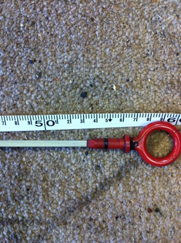

come to check the oil on the vr6 and plastic piece between the dipstick and the tube has completely crumbled away
anyone just pop out to theirs (assuming your levels are ok) and take off the orange (sometimes grey) guide piece and tell me where abouts your level is? if you could give us the both measurements one with guide one without that would be really helpful
got a journey 2mw and don't want to be low or in fact to high?
1st to do it gets a hug haha
Is this any god to you.

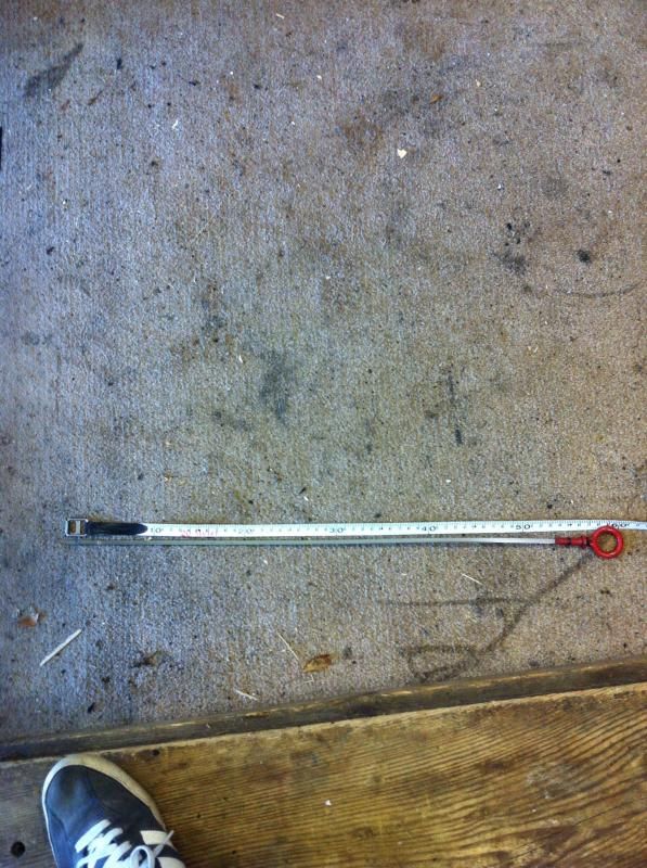

Total length of dip stick in the tube is 56cms, if you measure that from the end on you stick and then add a bit of tape, you can then dip the sump and get an accurate measurement if the tape aligns with the top of the tube.... How that makes sense...

yep that'll do nicely, cheers for that mate. i owe you one
