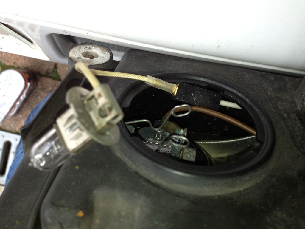

Just to expand on the fog light comment, you'll often find on the back of the light unit where the missing bulb would poke through, there's a disc that you can push out which allows you to fit the missing bulb, giving you two, working rear fogs as the connections are already there.

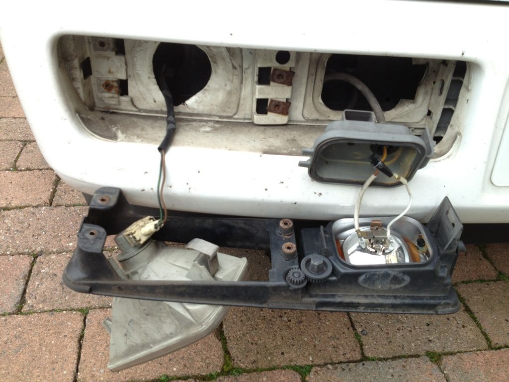

Upgrading bulbs...

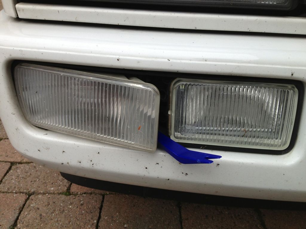

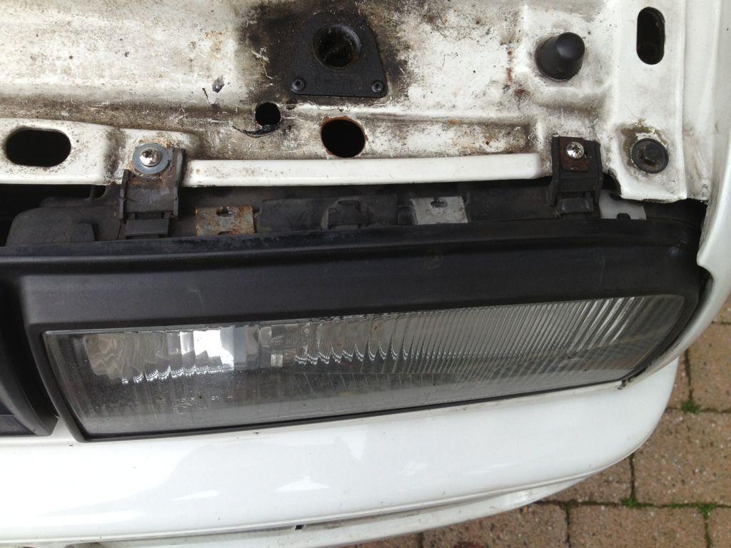

Fogs (normal bulbs)
Just lever it out (NO screws)!

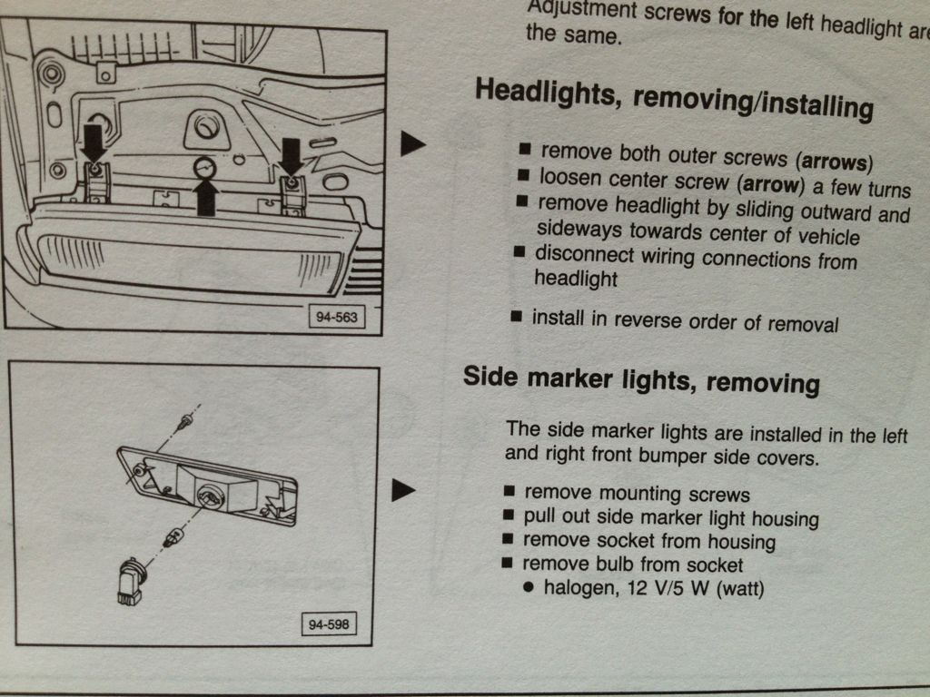

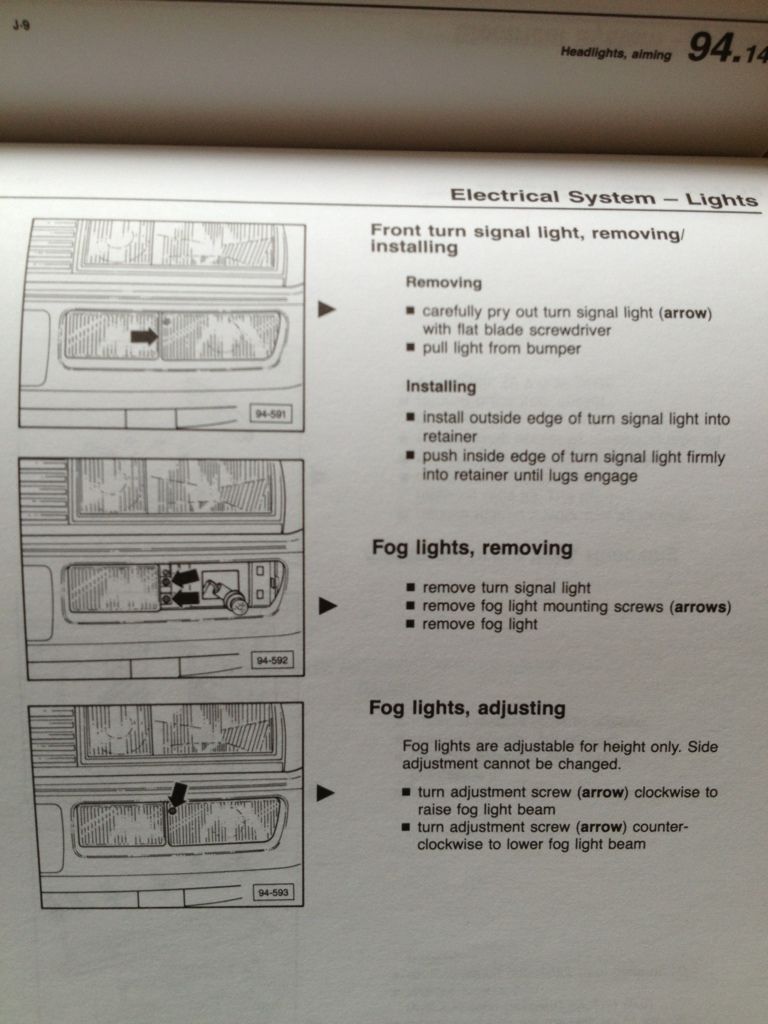

Now here the user manual AND Bentley wasnt clear.
BOTH say remove TWO screws next to fog light.
In fact, u have to remove FOUR screws to remove the WHOLE fog light housing! :shocked!:
WD40 to ease some of the screws/holes

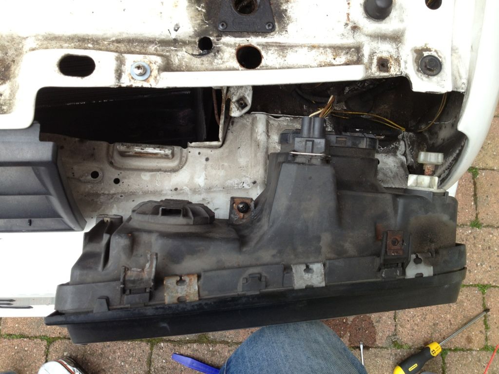

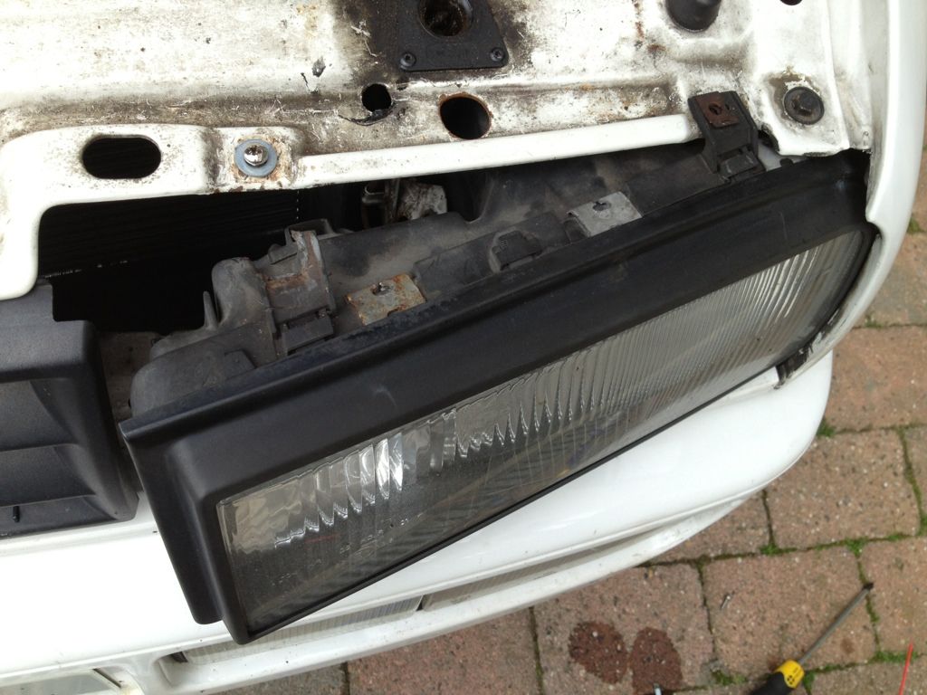

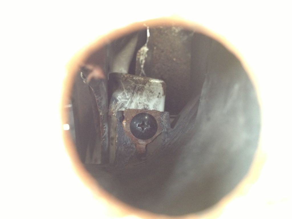

Headlights + high beam
Remove 2 screws either side + loosen (NOT remove) middle screw at bottom of hole (middle)

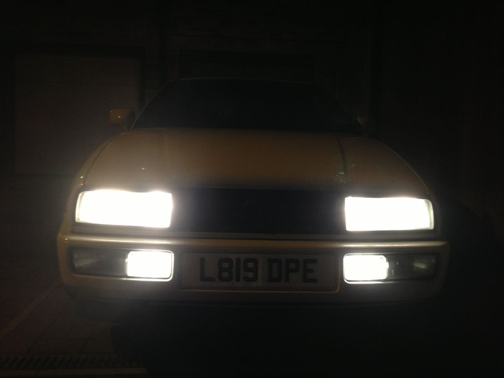

Upgraded brighter BLUE tinted high beam
Upgraded brighter headlights
Will test tonight to see effects! :thumb right: :cool:

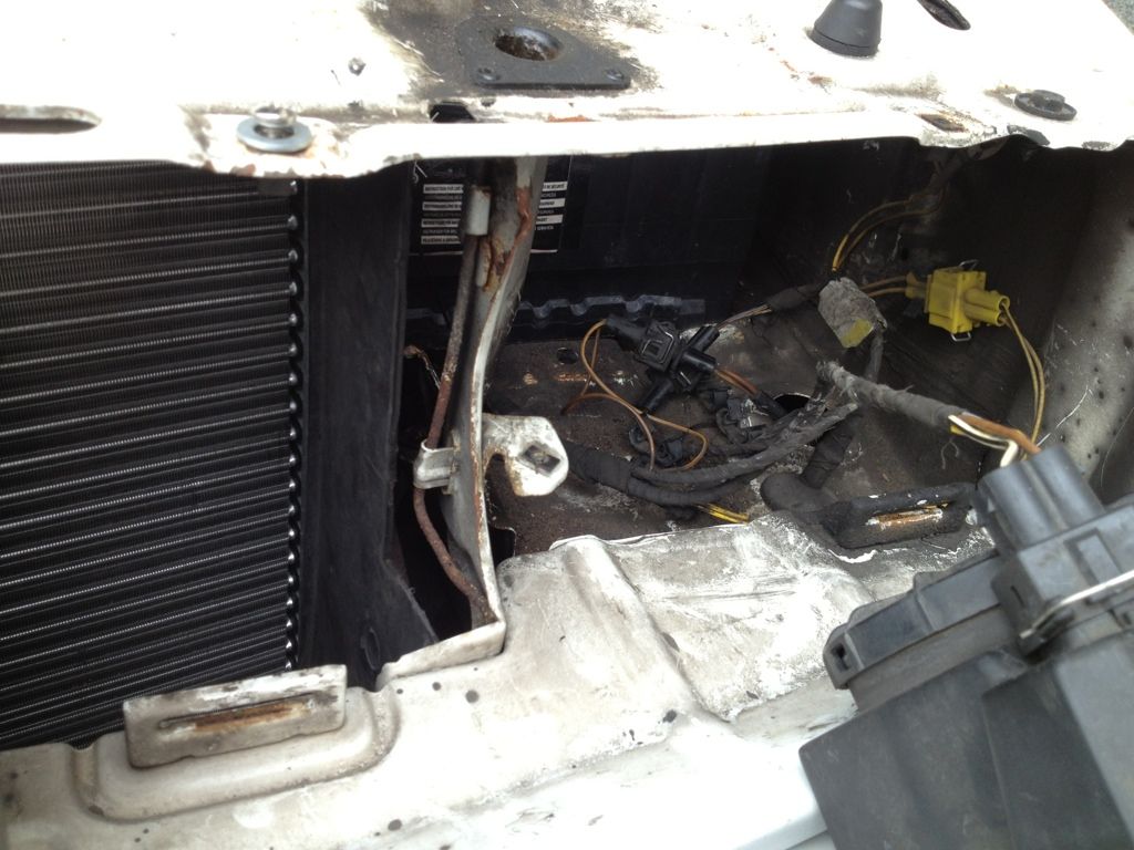

Get that loom plugged in while your in there. :cool:
I am NOT touching that thing without u with me! ;)

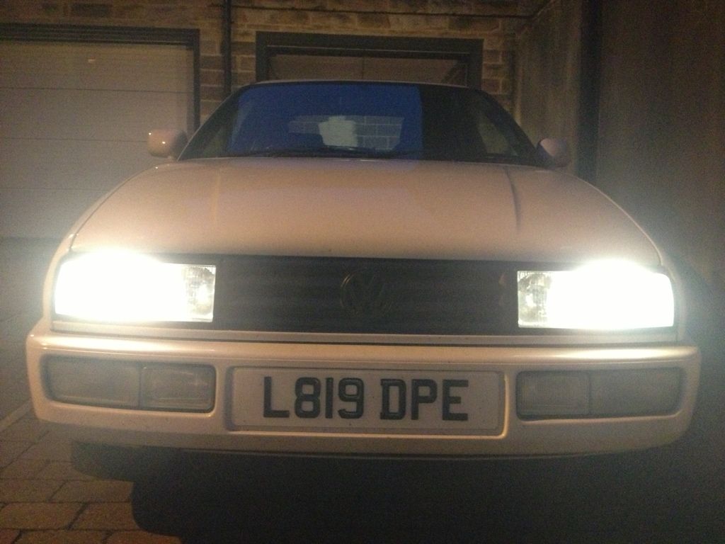

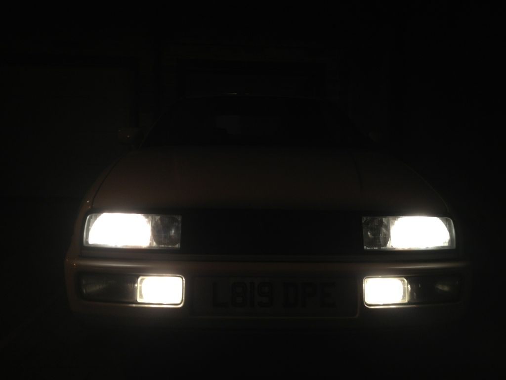

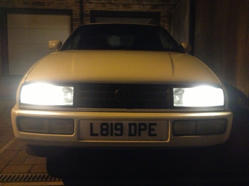

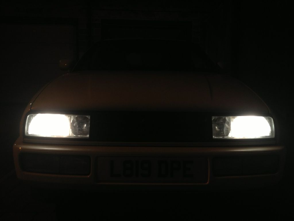

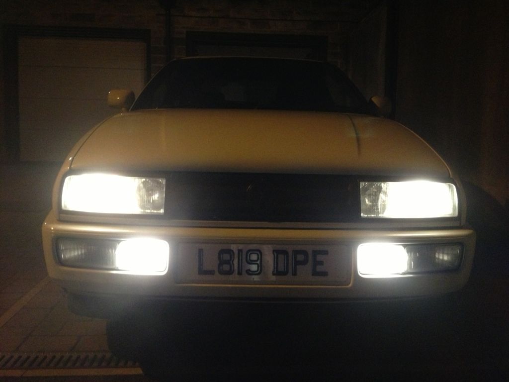

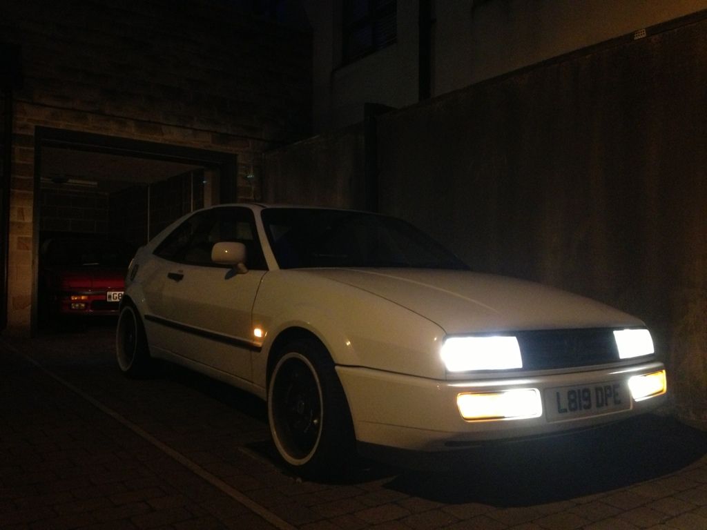

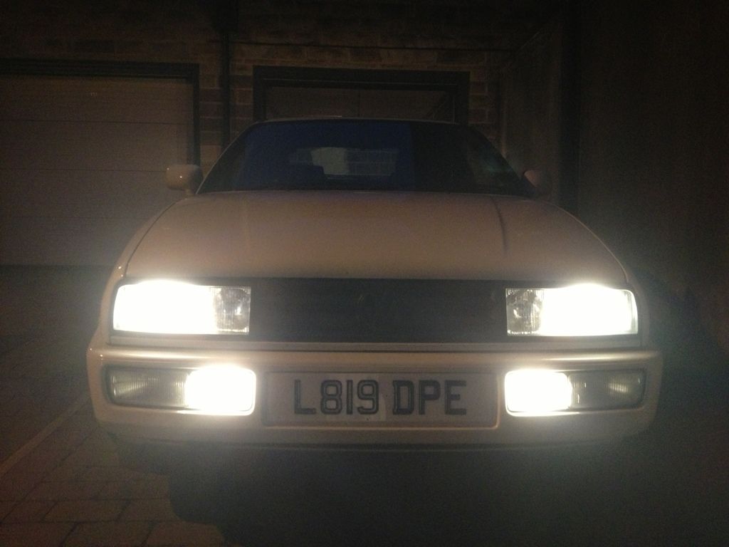

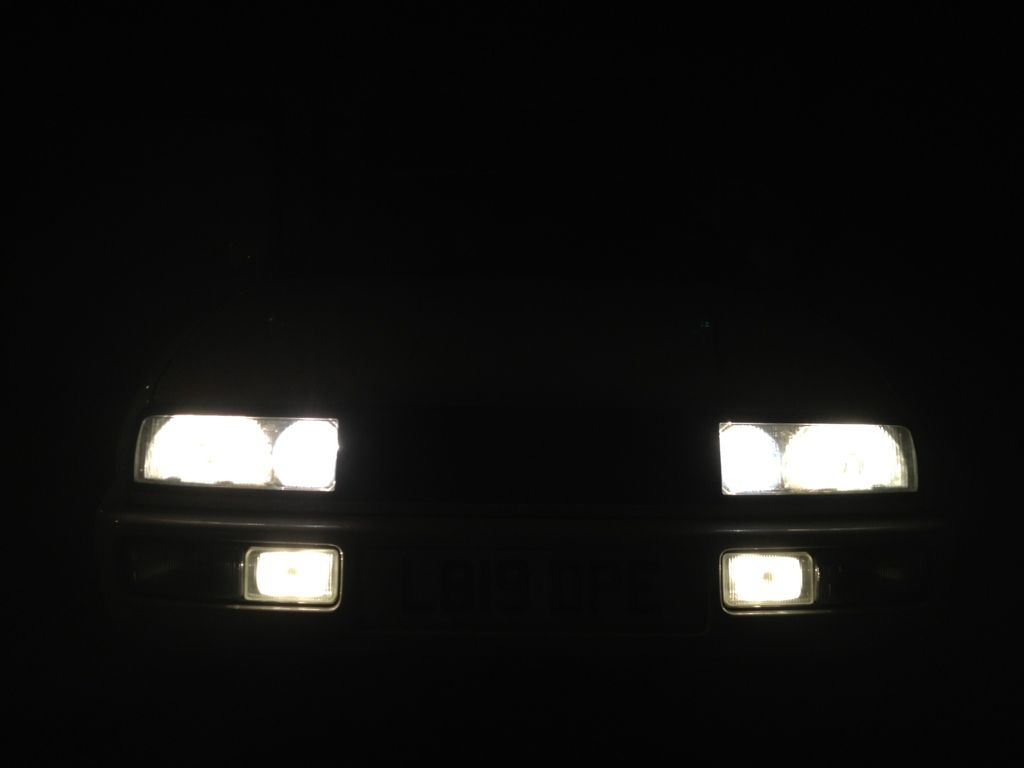

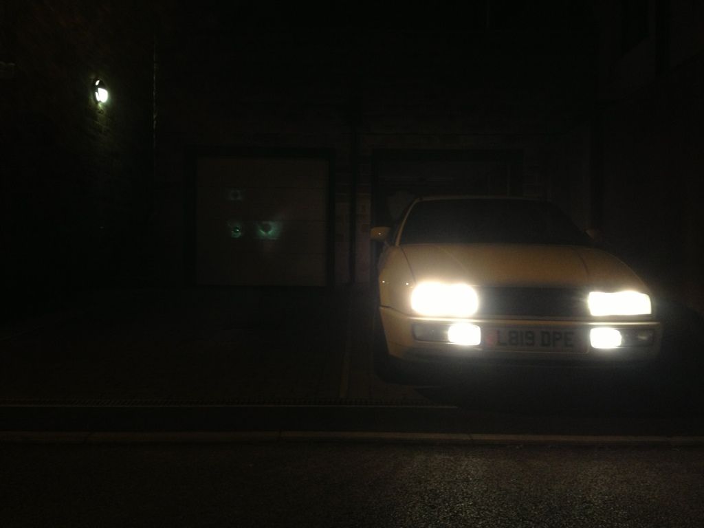

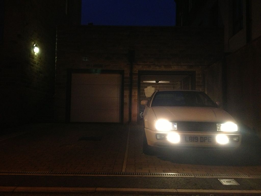

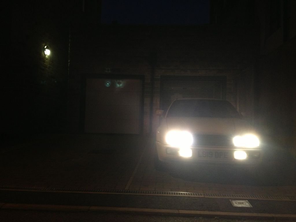

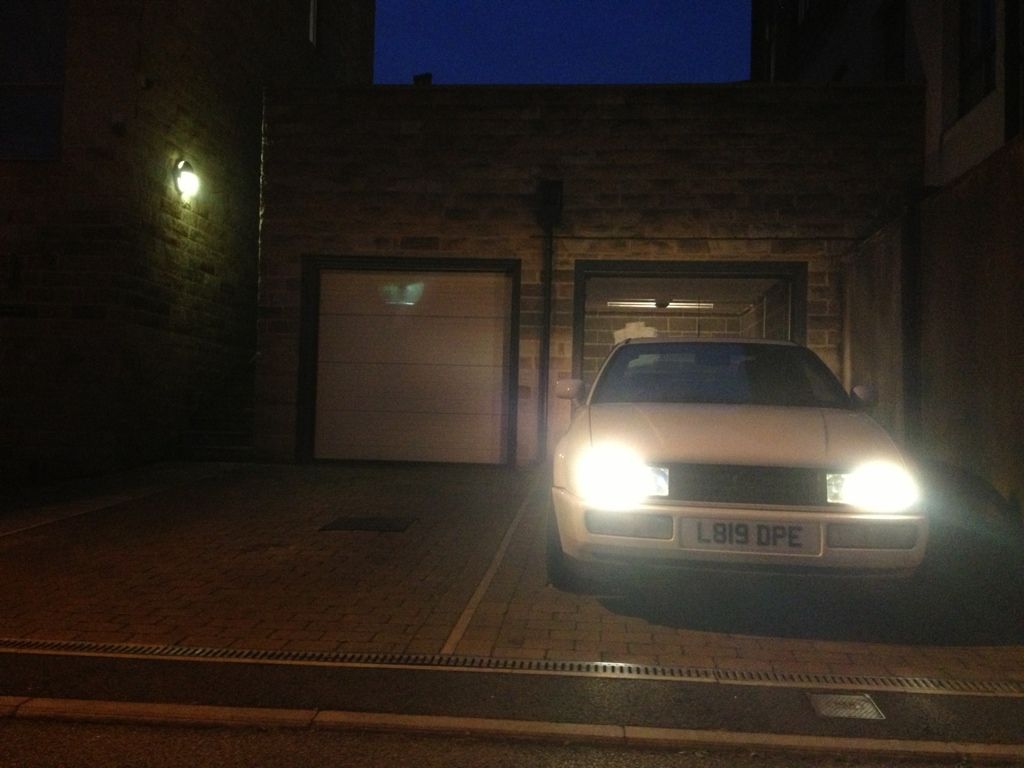

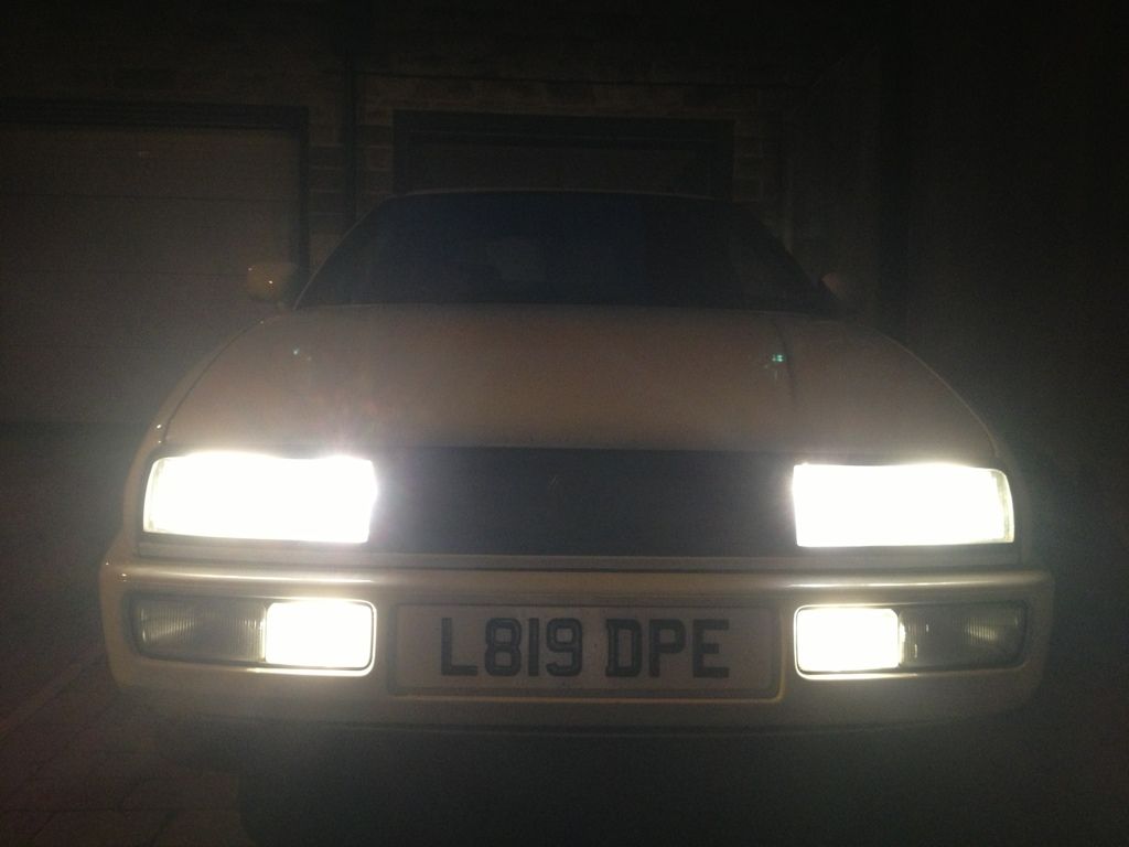

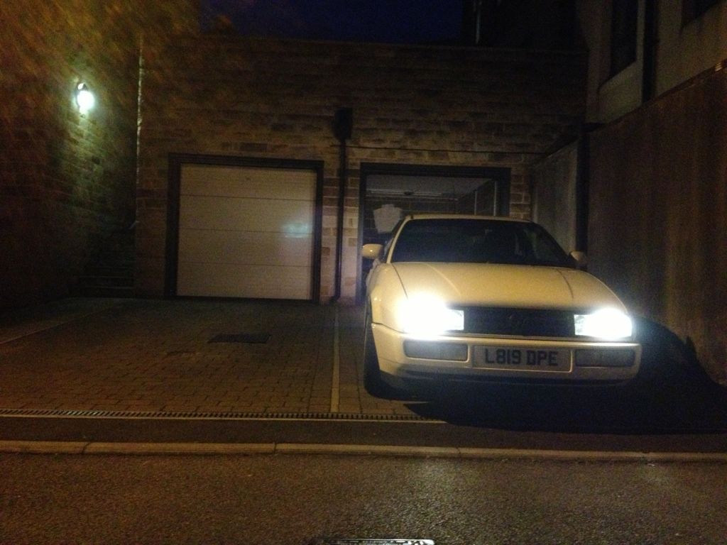

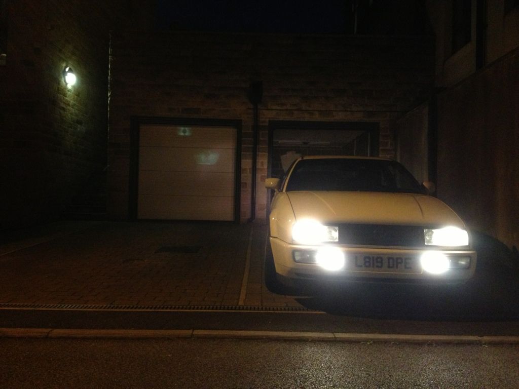

Comparisons between old bulbs and NEW OSRAM bulbs ...
OLD pic 1st, immediate followed by NEW pic ...
My opinion?
Pics shows new bulbs a tad bit brighter.
But in the driving seat they are a LOT brighter :thumb right: :dance:
(Apart from fogs, as new bulbs were just standard ones NOT upgrades)
But I suppose the cost of replacing all the front bulbs is much GREATER than adding a headlight upgrade loom :eek:

New problem - my headlight alignments are now out of whack! :eek:
According to manual,
The very headlight securing lugs (left / right) are for adjusting vertical/horizontal movement ...
...and all mine are broken :shocked!: :(
Edited by Wayne2015
That small bulb looks like the one in the central heater control knob that illuminates the panel. Just pull the knob off and you'll see a green plastic bulb holder.
Ref the headlights, the top two mounts don't adjust as far as I'm aware, you've got adjusters on the back of the headlight unit.

What about fog light alignment?

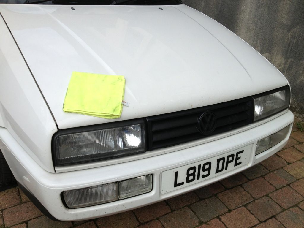

Noticed my front lights are GLASS and indicators are PLASTIC
So may give this a go ...
From Detailing World:
http://www.autopia.org/forums/the-detail-institute-presented-by-autopia-carcare-com/41903-autopia-guide-headlight-restoration.html
Not a fan of machinery polishers,
but will see how long my elbows (or weak heart) will last!
:eek:
:shocked!:
Well
Decided against sandpaper/machine polish...
NOT brave enough :eek: :shocked!: :(
So gave lights a clean detail ...
Not sure it made any difference by hand??? :eek:

Screw on the back is a mounting screw, only adjustments goes via the big white knob for height, and the gear-ish screw for horizontal adjustments.
Corrado's with electronic height adjustment, have a motor instead of a knob, but have a large brown sprocket on the back of the motor which is also for adjustments.
