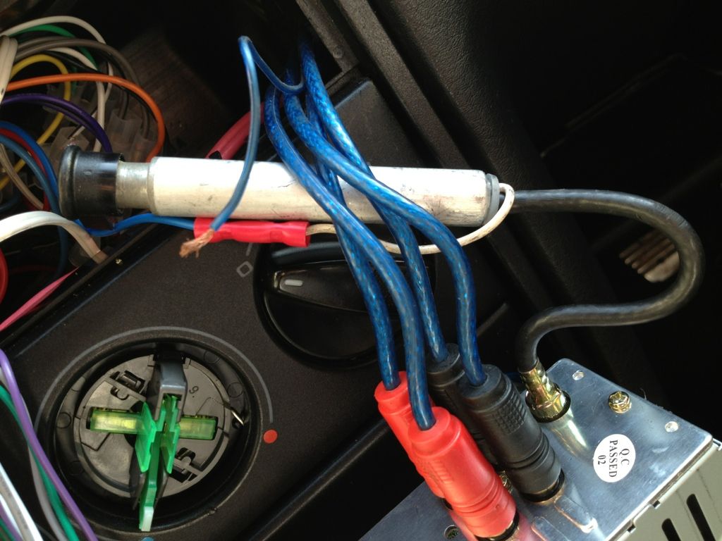

But looking at the back of my after market stereo
Ok
ISO socket for speakers OR
RCA sockets?
From the back
It looks like both ISO + RCA sockets are used???

What is this cut BLUE wire?
And this component on the aerial cable?
Is it my aerial booster / amplifier?
(As I dont have a booster/amplifier in base of my roof aerial?)

ISO leads power speakers from the head unit's internal amp (fronts, rears, both or none at all if external amps used).
RCA's go to amp(s) to power speakers (possibly fronts, rears, sub or all 3). I assume you must have/had one or more amps if RCA's fitted and must go somewhere.
Both ISO and amps can be used at the same time but not to power the same speakers.
Re 6 speakers - treat as 4 speakers - the dash tweeters/door woofer are one set (components) fed by amp or head unit. The rears are the other set (you do however have 2 sets of rears - standard location and parcel shelf)
The Blue wire you found may be the amp switching lead but without looking I couldn't say.
Yes you found an aerial signal booster.

Thats an inline aerial booster.
But when i plugged my new aerial directly into the stereo,
the radio was still crystal clear! :shrug:
Shall i just bypass the booster?
Or cut some wires to make new aerial plug into booster?

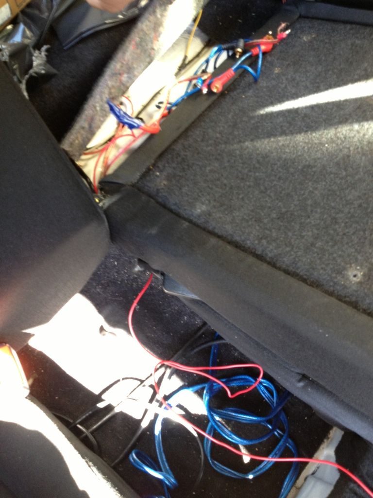

As above, the other end of the rca leads are probably under or behind carpet/trim/seats in the back somewhere (where an amp used to be).
Rear seats
Boot

Just seen your picture of where the RCA's leads go to and saw that red wire coming from the centre consul and wondered if this was the live feed for an amp that someone left loose :suprised:
It may be worth lifting your seats just to check where it goes and that it's not a live wire.

It doesn't look suitable for an amp, but worth checking out. I hate bodged wiring on cars which is why I've sorted any I found on mine.

Now that red looks like an amp wire. Usually the wire would have an inline fuse just off of the battery.

Black doesn't need taping, red wants removing ideally (unless you want to fit an amp) but to do this you'll need to remove the fuse (if it has one and hasn't already been removed).
Leave it all taped up and I'll sort it for you later.
