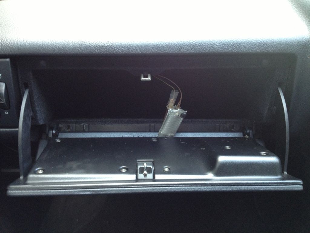

Removing dash speaker + vent grilles and glove box ...
(When I was installing aerial cable etc)

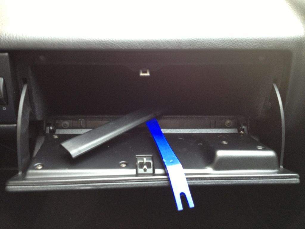

Glove box 1st

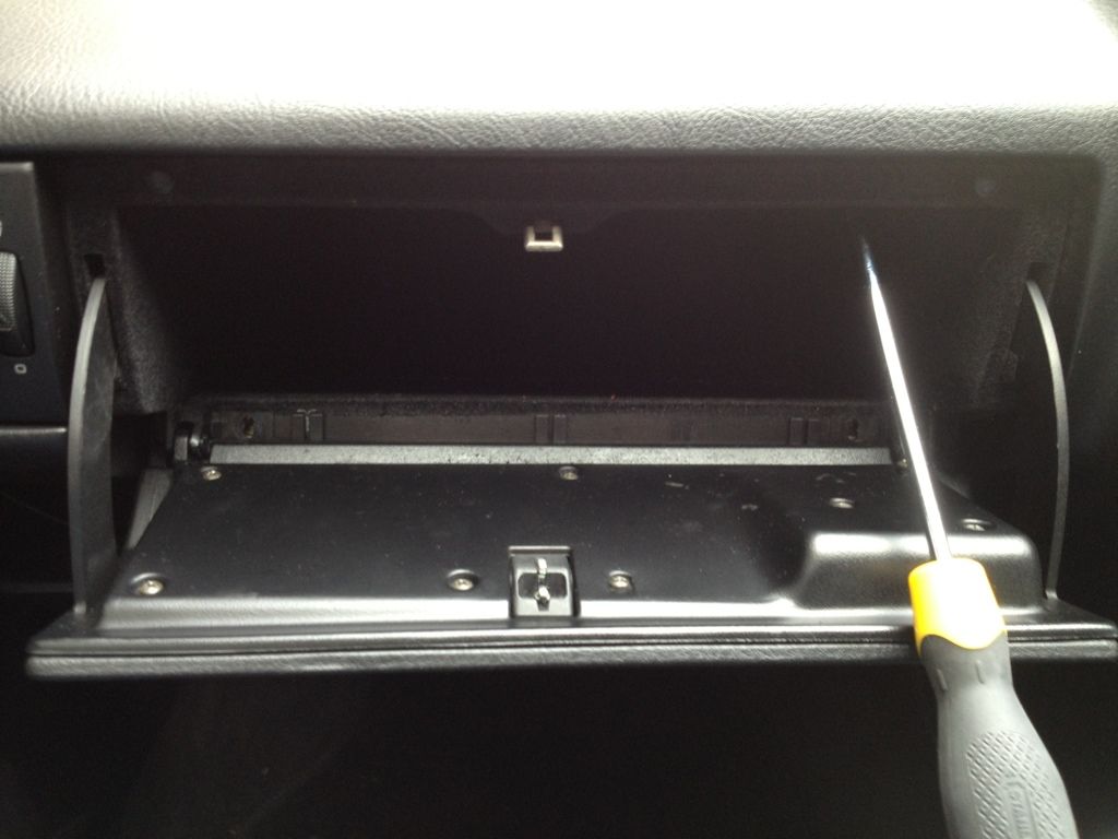

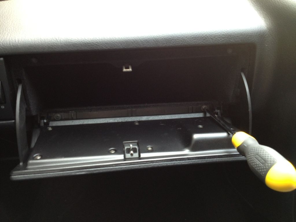

Remove plastic cover on bottom of inside glove box door
(Just prise off)
x2 screws bottom
x2 screws top
Remove glove box light

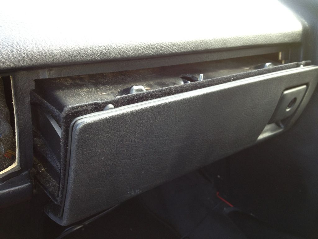

NOW

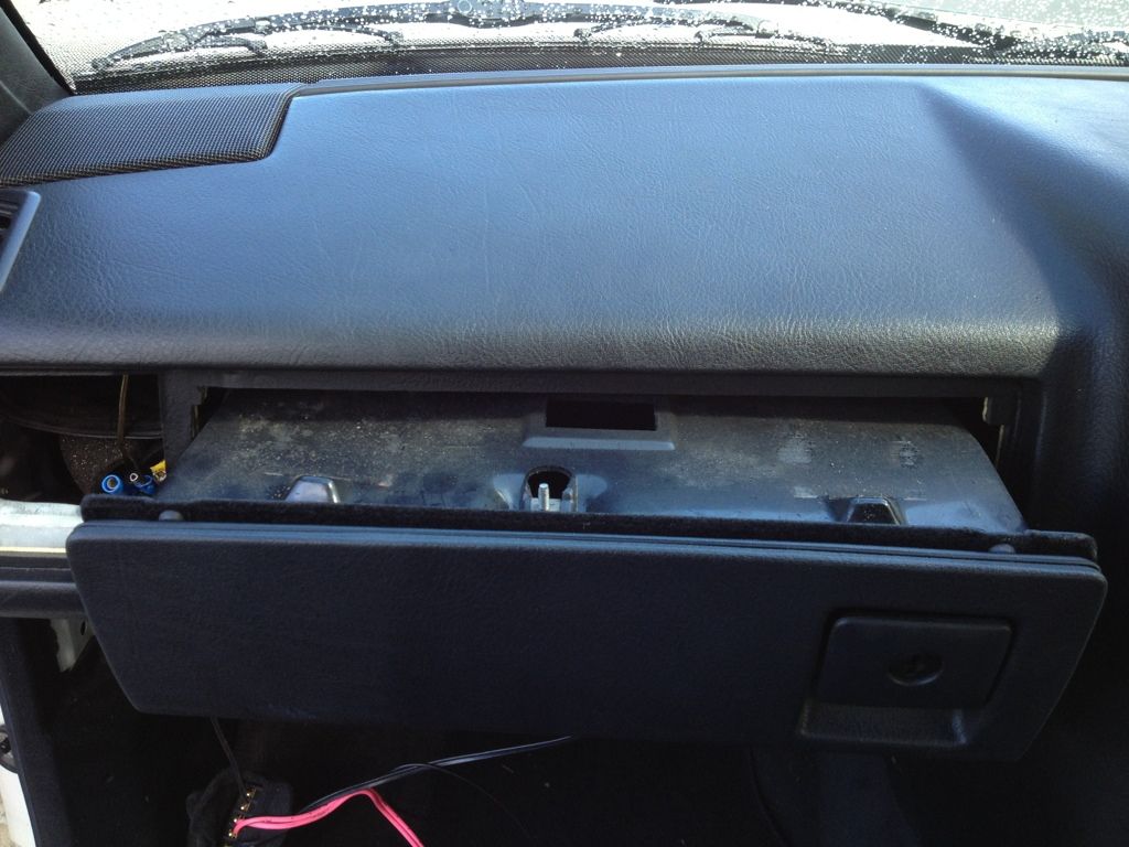

Be ready for a lot of sweat, elbow grease, bleeding and f-ing...
Pull out
The problem is it will not SLIDE out.
Its a VERY VERY tight gap for glove box
PLUS there is a piece of plastic that PROTRUDES all along the bottom of the glove box
AND the gap is NOT big enough for this EXTRA protruding
So u literally need to PUSH/BEND/SQUASH the bottom of the glove box for this protruding bit to JUMP over the glove box housing (or frame) and force it out (good luck breaking anything :eek: :shocked!: )

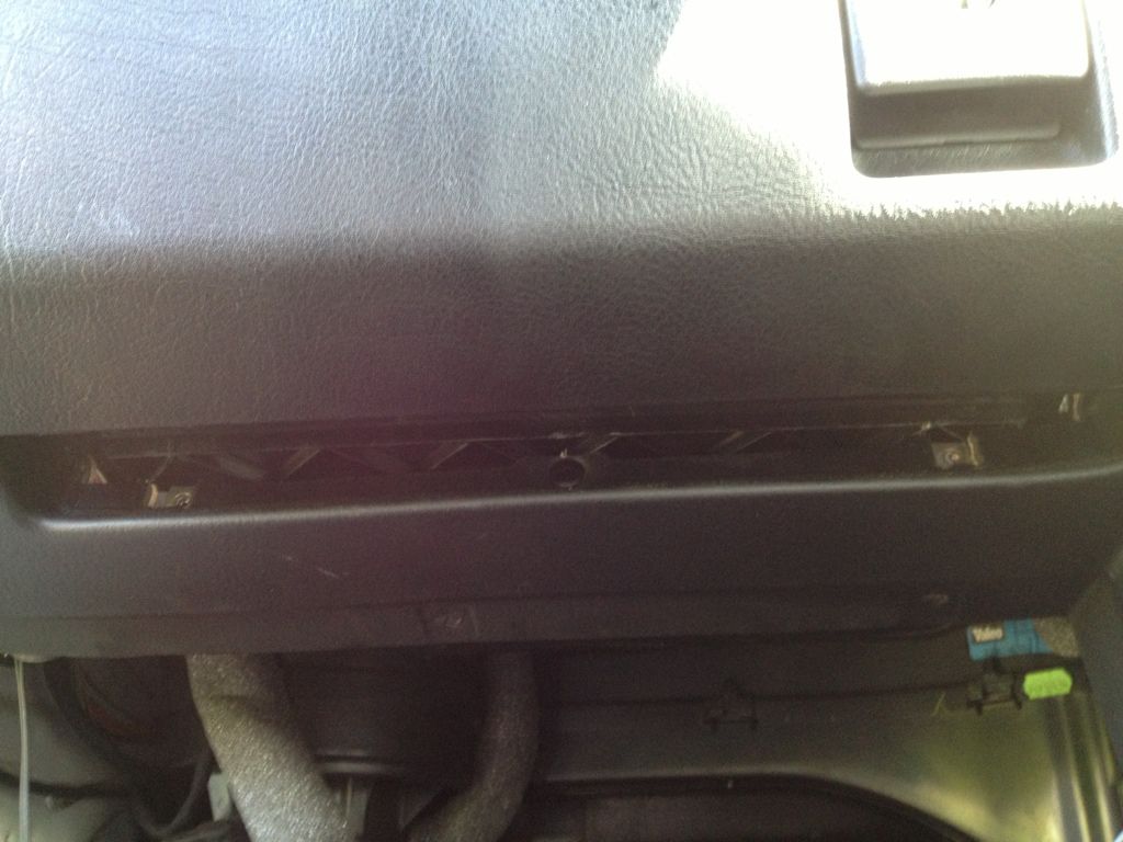

U can just about see the protruding bit along bottom of glove box (criss cross plastic)

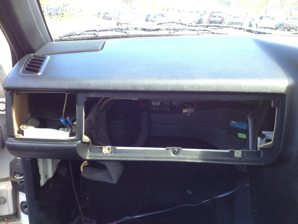

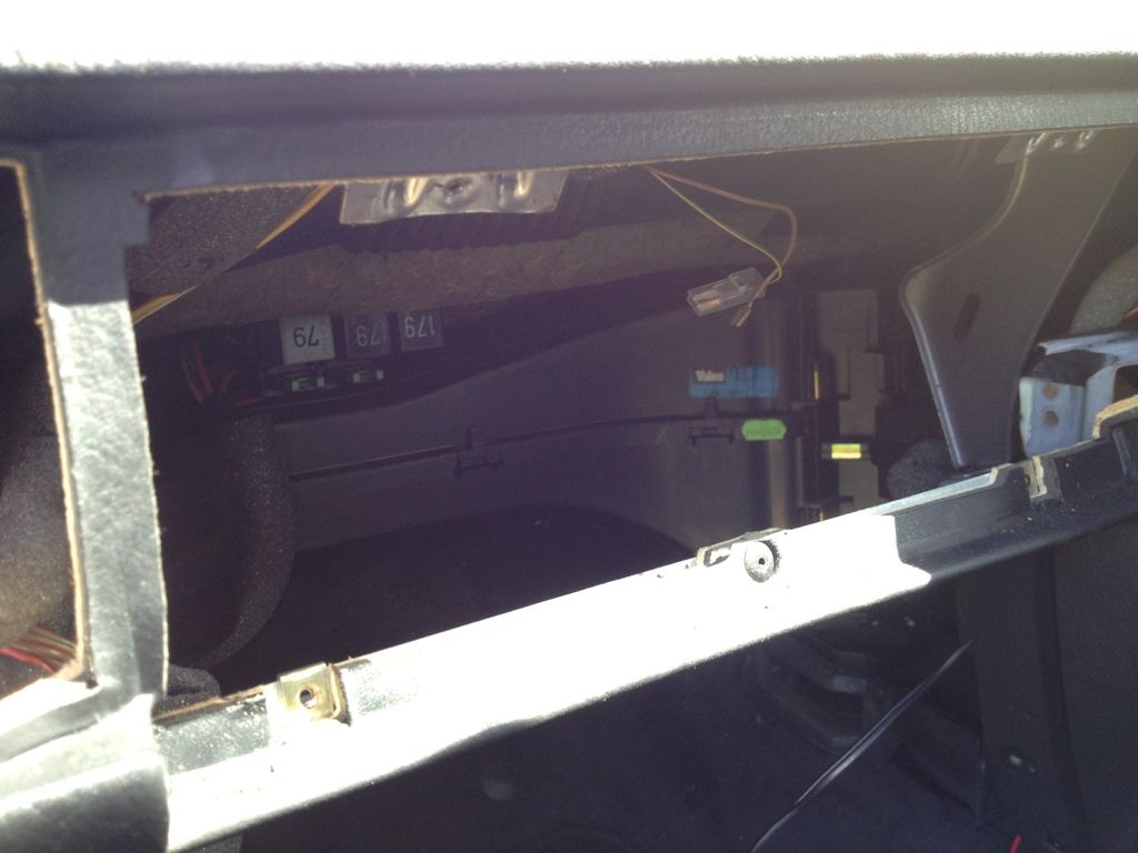

Ok (I cheated and took dash vents out 1st - but makes no difference!)
And the METAL bar on bottom of glove box housing for the protruding part to jump over :shocked!:
