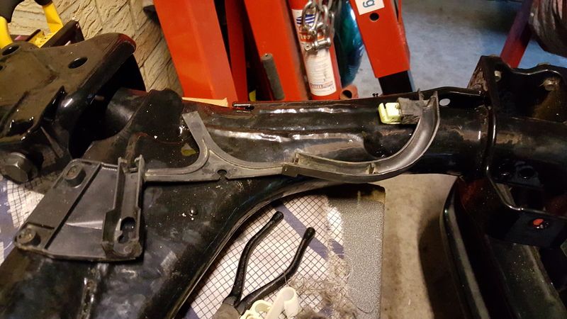

Jim Bowen 1 Posted April 29, 2015 Perfect. Thanks. The problem I have is I think the studs for clips are in the wrong place. It's not my original beam. It's a replacement but the black plastic bits won't got on. Not sure if pics explain. Seems like the beam is longer. Quote Share this post Link to post Share on other sites

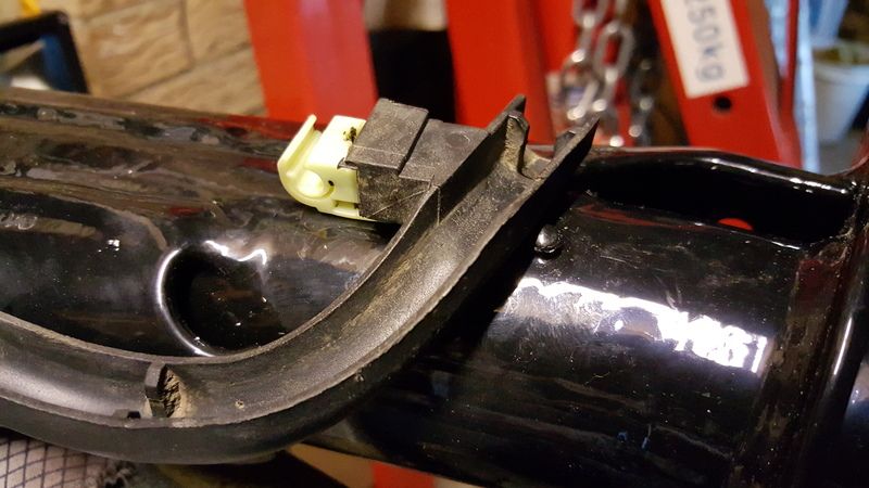

Jim Bowen 1 Posted April 29, 2015 First pic the white clip is on the stud. But other end is way off. Other pics show if I clip the black bit on first the white clip misses the stud. Quote Share this post Link to post Share on other sites
ChrisL 20 Posted April 29, 2015 Is your vr a late one? Mine is a late beam and the studs are threaded, when I did goldie's beam which is an 'L' reg, it had studs like the one on the pictures which were different. Wonder if the beams are different? Quote Share this post Link to post Share on other sites
Jim Bowen 1 Posted April 29, 2015 Mine is a 1995. Annoyingly I haven't got the axle I took off to compare. The clips that came off don't look like they have been on a thread. But they also don't stay on the studs. Would be weird for the axle to be longer that way. But that's how it seems. Or more likely studs in different place. I might look into p-clips and do away with the white and black bits. Just hoping the axle is correct size. Quote Share this post Link to post Share on other sites
ChrisL 20 Posted April 29, 2015 Both of mine have been 1995 cars with threaded studs. The plastic guide on your picture and the White clip are the same as mine. There is another little stud on your picture in the filet piece where the rigid brake line clip goes, that should also be a threaded stud for a 1995 car. Quote Share this post Link to post Share on other sites
ChrisL 20 Posted April 29, 2015 Both of mine have been 1995 cars with threaded studs. The plastic guide on your picture and the White clip are the same as mine. There is another little stud on your picture in the filet piece where the rigid brake line clip goes, that should also be a threaded stud for a 1995 car. If you look at the picture sent by Philly, the stud near the wheel axle looks further up the beam then yours. Quote Share this post Link to post Share on other sites

ChrisL 20 Posted April 29, 2015 Vr6 are different and as I say, goldie's was different to mine. If you have the old beam it's worth checking stud centres Quote Share this post Link to post Share on other sites
Jim Bowen 1 Posted April 29, 2015 Looking on vagca it does give quite a few different part numbers. Will try and measure old beam. Got fingers crossed I can use it as had it coated and fitted bushes to it. Are the older clips different to fit on the studs? I have some that slide on which I reckon came off this beam. Quote Share this post Link to post Share on other sites
ChrisL 20 Posted April 29, 2015 I'm not sure but looking at those studs they look like the clips would slide on. I reckon you should be fine if you get the right clips. Quote Share this post Link to post Share on other sites
corrado wannabe 13 Posted April 30, 2015 JIm, I tried to take pictures of the beam I have lying in the garage at the moment. Unfortunately: A: The pictures were shheeeiiittee B: I dont know what age/vehicle it came off. I am sure it was from a late 16V. But both the one on my car and the one in the garage dont have a theraded stud on them, it as the ones in your pictures they have a small flat top to them that the clip slides onto. Just a thought, are the black plastic fittings handed? Dougie Quote Share this post Link to post Share on other sites
Jim Bowen 1 Posted April 30, 2015 I've managed to buy some of the slide on type clips which should work with this axle, so as long as brakes pipes and the ABS wiring is secure i'll be happy. Am just hoping its the right width of beam for car. going to try and find my old axle to compare (i gave it to a mate to scrap, hopefully he hasn't been yet) Quote Share this post Link to post Share on other sites

Jim Bowen 1 Posted May 1, 2015 Found my old beam last night, luckily my mate hadn't binned it yet. The dimensions of the beam are the same so that's good news. But can see the studs for the clips are different. Just wondering now if the earlier axles had different black plastic bits (that hold the ABS sensor wire) as they don't fit this axle. Quote Share this post Link to post Share on other sites
corrado wannabe 13 Posted May 1, 2015 I can maybe help with that when I get home Jim, I think the part numbers are still visible on the plastic bits on mine so I will post them up in case they are different on yours. No doubt someone will beat me to it though. Dougie Quote Share this post Link to post Share on other sites
Jim Bowen 1 Posted May 1, 2015 Nice one, would like the proper duct things if they are some, if not i've have to get inventive with some clips Quote Share this post Link to post Share on other sites
corrado wannabe 13 Posted May 2, 2015 Jim, sorry for the delay in getting it on here: n/s is part number 535 971 851 o/s is part number 535 971 852 Hope this helps Dougie Quote Share this post Link to post Share on other sites
