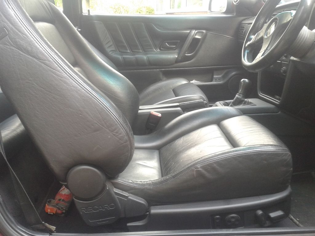

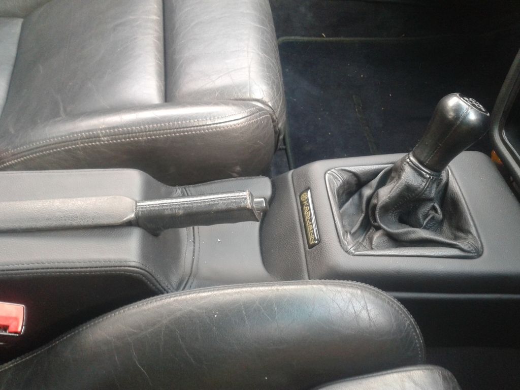

lilfuzzer 1 Posted August 18, 2015 Will dig some out when on computer later chief Quote Share this post Link to post Share on other sites
lilfuzzer 1 Posted August 18, 2015 http://the-corrado.net/showthread.php?47736-Lilfuzzers-quot-Verity-quot-has-a-new-home-finally!!/page6 will take some more tonight Quote Share this post Link to post Share on other sites
lilfuzzer 1 Posted August 18, 2015 sorry poor pics as bad light in garage few taken last year tight to centre trim Quote Share this post Link to post Share on other sites
Declan Sedrick Lehane 10 Posted August 18, 2015 They do look good in the c then! Thanks for the photos! Quote Share this post Link to post Share on other sites
lilfuzzer 1 Posted August 18, 2015 NP mate and yes they do suit it well. Just the motors underneath take a lot of effort Quote Share this post Link to post Share on other sites
Declan Sedrick Lehane 10 Posted August 18, 2015 What needs to be done to the motors underneath? Do all the electrics work after the effort? Quote Share this post Link to post Share on other sites
lilfuzzer 1 Posted August 18, 2015 Declan Sedrick Lehane said: What needs to be done to the motors underneath? Do all the electrics work after the effort? Yes mate it seems that the motors and all the wires are for memory settings extra. Took them to a guy who is a wis with electrics and stripped the wires down but the motors reamin and the weight stays. Also they need bolting to the floor Quote Share this post Link to post Share on other sites
