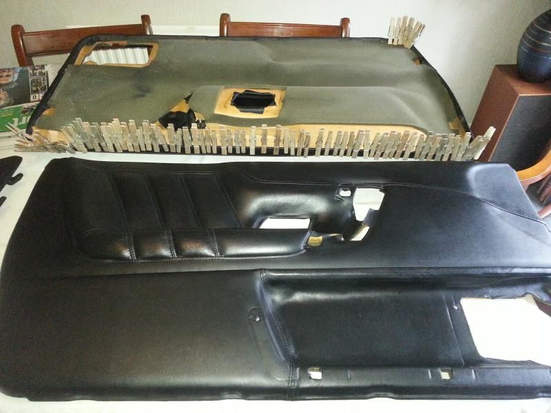

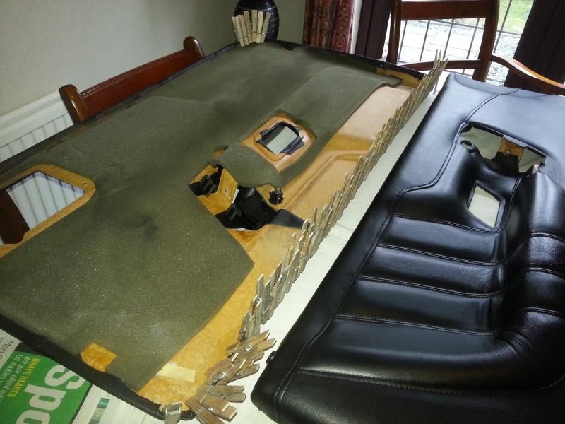

Jim Bowen 1 Posted September 1, 2015 Something like this http://www.as-trim.co.uk/index.php?main_page=product_info&cPath=1_18_31&products_id=71 They also do a thicker glue of the same type. Quote Share this post Link to post Share on other sites
Jim Bowen 1 Posted September 1, 2015 i did mine recently and just used a normal superglue i had lying around Quote Share this post Link to post Share on other sites
SR_Neale 10 Posted September 1, 2015 Cheers jim. I knew I had seen your pics with the pegs but just couldn't remember where. Did you have any issues with using normal super glue? Quote Share this post Link to post Share on other sites

Jamie 1 Posted September 1, 2015 I use this and it's excellent. http://www.as-trim.co.uk/index.php?main_page=index&cPath=1_16_20 The only thing to be wary of with superglue it does eventually go brittle and will start breaking up Quote Share this post Link to post Share on other sites
SR_Neale 10 Posted September 1, 2015 Jamie said: I use this and it's excellent. http://www.as-trim.co.uk/index.php?main_page=index&cPath=1_16_20 The only thing to be wary of with superglue it does eventually go brittle and will start breaking up I think I'll give this a go. Wasn't over keen on using super glue due to the possibility of it bleeding through and ending up with white blobs everywhere. How far does it go as there isn't a huge amount to do? Quote Share this post Link to post Share on other sites
Jamie 1 Posted September 1, 2015 SR_Neale said: I think I'll give this a go. Wasn't over keen on using super glue due to the possibility of it bleeding through and ending up with white blobs everywhere. How far does it go as there isn't a huge amount to do? It does go quite far. I reckon the smallest tin would be more than enough. Quote Share this post Link to post Share on other sites

Philly-R6 1 Posted September 1, 2015 I had great success with TrimFix High Temp spray adhesive. Just mask up everywhere and take your time. I used pegs, too... Quote Share this post Link to post Share on other sites
lilfuzzer 1 Posted September 1, 2015 Jim Bowen said: i did mine recently and just used a normal superglue i had lying around This sends shivers down my spine as used the same method very good but time consuming Quote Share this post Link to post Share on other sites
Jamie 1 Posted September 1, 2015 I didn't have to use any form of clamp - once that AS glue grabs it's stuck. The downside obviously is you need to get it right first time Quote Share this post Link to post Share on other sites
fonzooorooo 10 Posted September 1, 2015 If you need more pressure from the retro pegs, wrapping rubber bands round them works well. Quote Share this post Link to post Share on other sites
