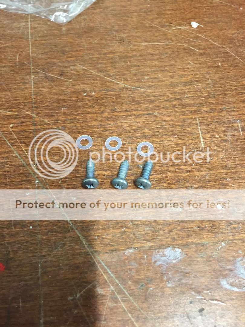

Philuk 0 Posted April 14, 2016 Anyone got any ideas ont he sizes of these? are they just a screw or i read somewhere that there is some plastic washers that go on before? was gonna replace the standard ones for stainless but arent sure what i need to buy :D Quote Share this post Link to post Share on other sites
delfinis38 1 Posted April 14, 2016 (edited) Anyone got any ideas ont he sizes of these? are they just a screw or i read somewhere that there is some plastic washers that go on before? was gonna replace the standard ones for stainless but arent sure what i need to buy :D Changed mine for stainless can't remember what size self tapper but the one I put in was longer than standard as it was all I had left over from front wing linings and front fogs. Didn't bother with the flimsy plastic washer as they fell apart on the orig.. But I put a smudge of clear sealant there. Edited April 14, 2016 by delfinis38 Quote Share this post Link to post Share on other sites
Philuk 0 Posted April 14, 2016 might just buy a multipack of stainless sc rews then and do the same with the silicone :) Quote Share this post Link to post Share on other sites

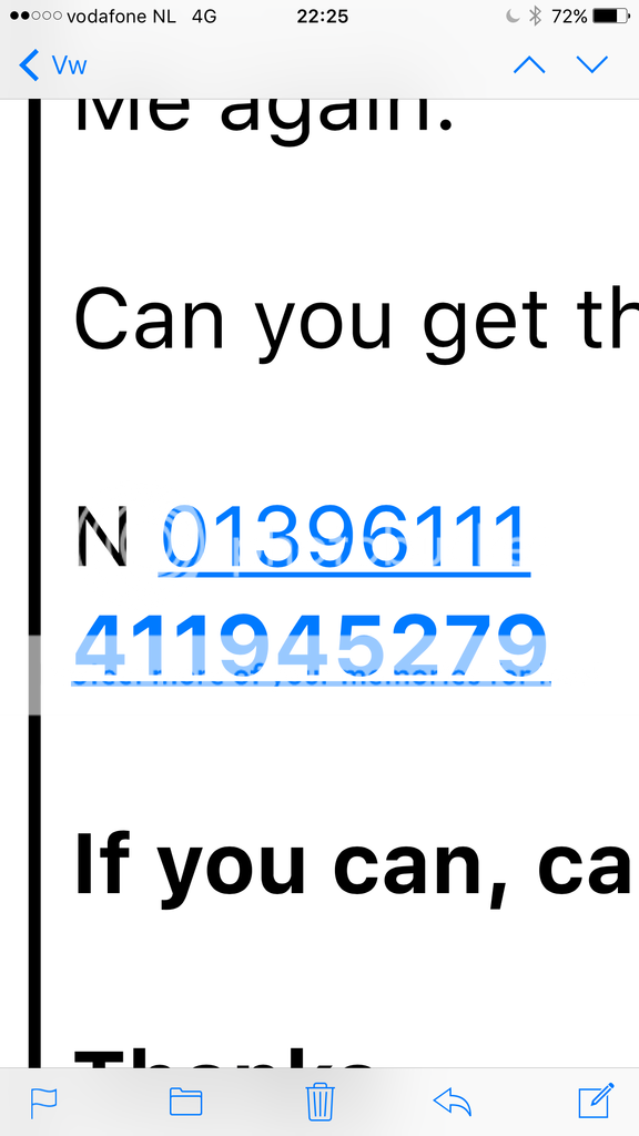

seanl82 23 Posted April 14, 2016 N01396111 or N0139612 - oval head panel screw; 3,9X13 411945279 - plastic washer 3 required of each. Quote Share this post Link to post Share on other sites
massbad69 10 Posted April 14, 2016 Just got them from VW for 85p Quote Share this post Link to post Share on other sites
massbad69 10 Posted April 14, 2016 Part numbers for screws and washers as Sean says Quote Share this post Link to post Share on other sites

Philuk 0 Posted April 15, 2016 when im looking at these bits i must be close! Quote Share this post Link to post Share on other sites
