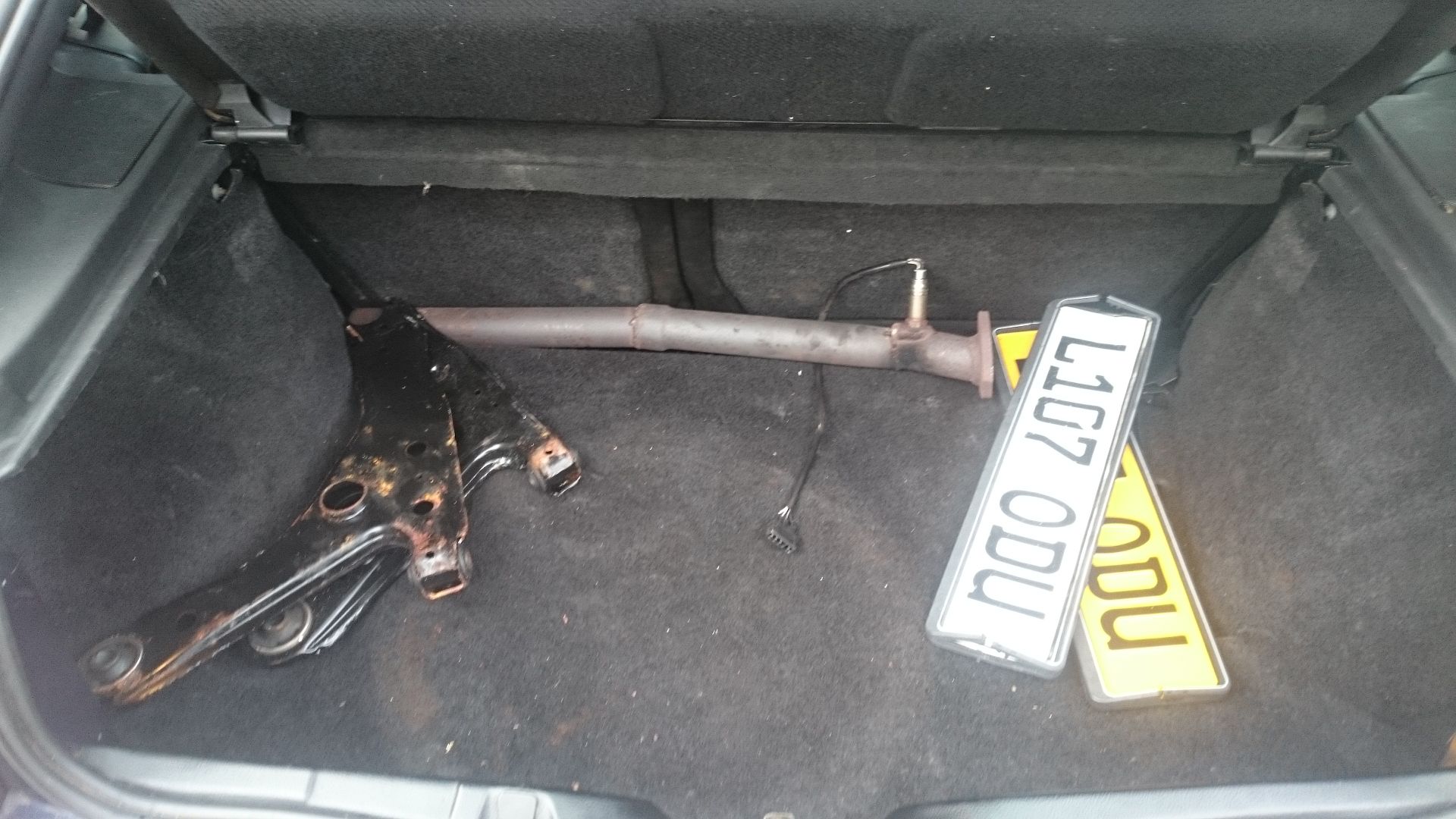

May be an easy fix then if the de-cat was passed onto you? When I got it there was a de-cat in place. I swapped it out for a second hand cat and lambda I got from lilfuzzer but left the de-cat with attached lambda in the boot for the new owner. Was it passed onto you?

Here is a sale pic with what I left for the new owner

Thanks mate, that decat must be long gone, and I think the wishbones are on the car!
