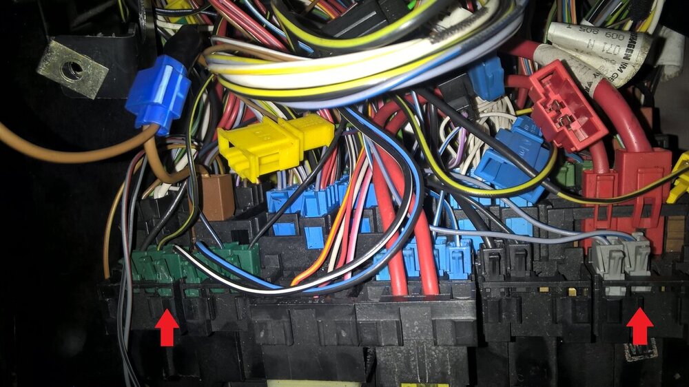

_Matt_ 32 Posted June 12, 2023 Yeah power wise they work on movement. I'm just not convinced I've done the heated seat part right but have no other spaces on my fusebox to slot them in. I have another corrado in my garage, which I tool the loom from, however the layout across the top of the fuse box is completely different! Quote Share this post Link to post Share on other sites
Philly-R6 1 Posted June 29, 2023 Here is a photo of where my heated seats harness connected: Quote Share this post Link to post Share on other sites
