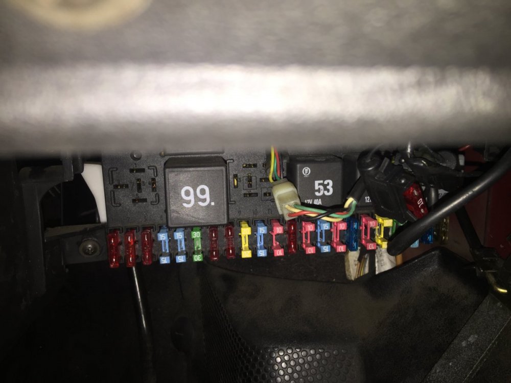

FrankyEight 10 Posted February 14, 2021 Hi guys I've recently had a problem of my car cutting out immediately after it being started. This happened the same day as my spoiler and sunroof stopped working. On closer inspection I found that one of my fuses had blown (it was a 15amp one, blue, 16th in from the left in pic). On replacing it the car started fine and I was on my merry way. Although, once home I've got the same issue and I can see that this same fuse has blown. My questions are: • Does anyone know what this fuse is for and what may have caused it to blow? • Does anyone have a fuse diagram for the 2.0 16v so that I can inspect it? • Is the spoiler/sunroof issue linked with the car cutting out and this fuse being blown? • Can anyone educate me as to what the relays do vs fuses? Thanks so much in advance! Quote Share this post Link to post Share on other sites
Dox 31 Posted February 14, 2021 I think you'll find the factory immobiliser uses the same fuse as the spoiler? I'd unplug the spoiler motor for a while, if it still blows check inside the rubber bellows between the car body and the boot for broken wiring Quote Share this post Link to post Share on other sites
FrankyEight 10 Posted February 14, 2021 Cheers Dox, I think you're right. Immobilisor, spoiler, sunroof and glove box bulb use it. The latter had blown and was the culprit. All's now well, thanks. Quote Share this post Link to post Share on other sites
