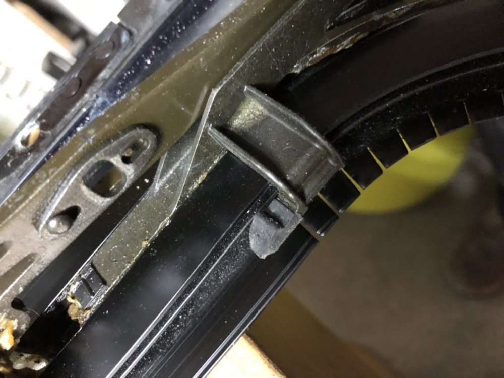

The inner panel needs the sunroof closed to be removed and refitted.
it arches to 2 hooks on the sunroof mech one near each corner. You have to push up firmly while pushing backwards, Be careful though as you’ll break the plastic on the inner panel if you don’t push up enough to clear the hooks.
As the mech move backwards and forwards it pushes the inner panel about with these hooks.
If yours is nearly closed it might help to do what cressa said and see if you can close it manually by messing with the motor, you can turn it with an Allen key or similar and the sunroof will move.
