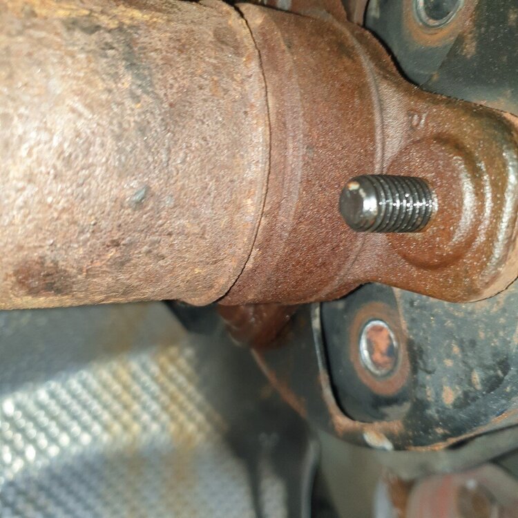

Anyone know if it's just 3 screws going from front to back that needs to be loosened to split the rear subframe/diff from the car on a 06 passat v6 (3c/b6)
Do one have to pull it backwards (is it on a spline going into the axel ?)
The screws on the picture is the ones still on . but I think they are supposed to be on the axel side?
To answer my own topic had to loosen 4 bolts under midle of car to be able to pull driveshaft forward to get it out from the final drive 🙂
