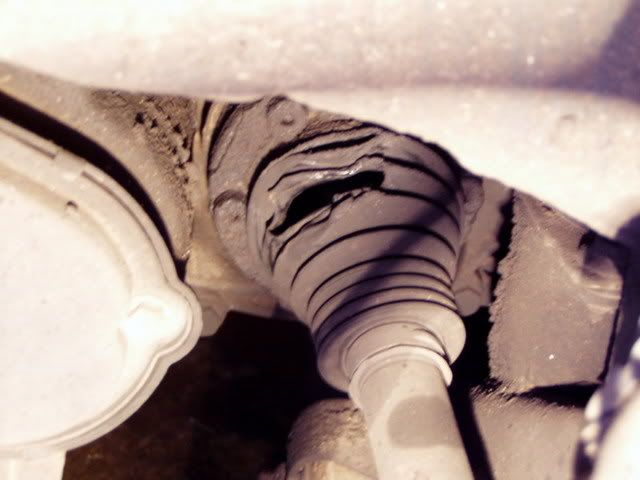

CLUNKING sound when turning at parking speeds
I have had this clunking sound for a while now, I was sure it was coming from the front near side and guess what I found toady...
Inner CV please sir...... :lol:
