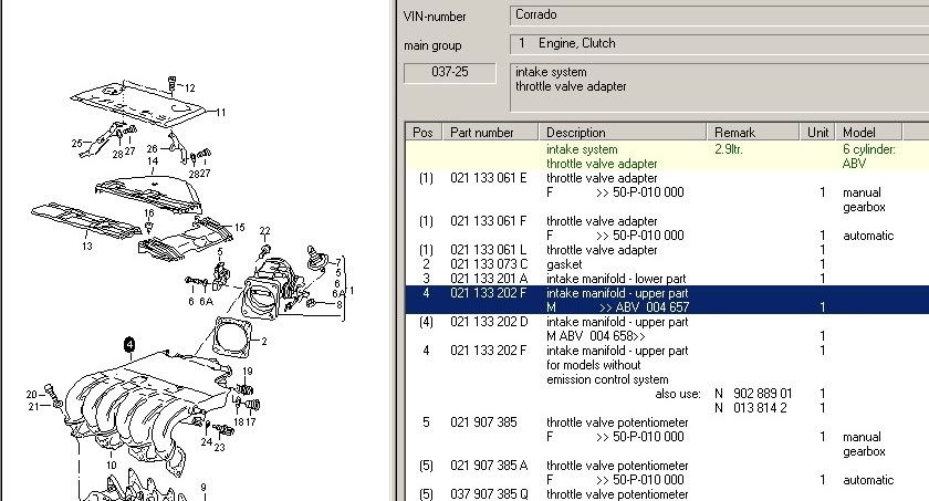

VWci 0 Posted December 15, 2005 I just found this number... They are different.... Quote Share this post Link to post Share on other sites
