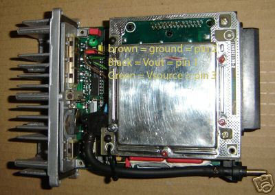

potatonet 0 Posted January 31, 2006 I have since found out that motorola makes these, this is what is installed in audi S4's for 250 KPA in motronic systems, I have bought the last 4 that are available from an allied electronics and will install one into my spare ECU so that I know they work. good times =-), I will still get one from a passat somehow. the same company also makes a 300 kpa one that I will buy 1 of if I can find someone who can make me a chip to go with it. eh the secrets out, they are motorola MPX4250AP's run about 20-25 bucks a piece US. Quote Share this post Link to post Share on other sites
potatonet 0 Posted February 1, 2006 figured out wiring, pin 2 - goes in the closest to the edge of the corrado ECU pin 1 goes next towards the other side of the ECU pin 3 goes last that is following german ebay instructions. Quote Share this post Link to post Share on other sites

potatonet 0 Posted February 1, 2006 2.5 bar: http://www.freescale.com/webapp/sps/sit ... 6990368716 3 bar: http://www.freescale.com/webapp/sps/sit ... 6990368716 that one uses pins 2-4 in the same order Quote Share this post Link to post Share on other sites

potatonet 0 Posted February 1, 2006 Used to.... there is the key, and how much did they cost? John was complaining that he couldnt get them either because they discontinued them. he hadnt heard about the motorola one yet. Ive never seen the ECU from a TDI passat =-/ and the pins make a difference. pins 4-6 are non active. this is on the universal motorola one, you might have had a different one? on the 300kpa pins 1,5-8 are non active. Quote Share this post Link to post Share on other sites
W3RKD 0 Posted February 1, 2006 Bosch 0.273.003.210 (250 kPa) Bosch 0.273.003.211 (300 Kpa) there are not available on there own anymore from bosch but you can buy the whole ecu second hand for a few £££ just for the sender. Looks like the one you found might work also as it seems a few of the guys in europe are playing with them also. Quote Share this post Link to post Share on other sites

samg60 0 Posted February 1, 2006 OK thanks mate I may well take you up on the offer. are yours a straight swap ? for the standard sender or is there a bit of rewiring needed ? Quote Share this post Link to post Share on other sites
potatonet 0 Posted February 2, 2006 there is a small bit of wiring, 3 wires and a ziptie, the passat TDI one is a straight swap, same mounting holes, I might be doing a 300 kpa system because of the high boost levels I will be reaching. hope the headbolts stand up to it. =-/ Quote Share this post Link to post Share on other sites
potatonet 0 Posted February 2, 2006 here I will post the picture: http://i6.photobucket.com/albums/y207/p ... wiring.jpg Quote Share this post Link to post Share on other sites
