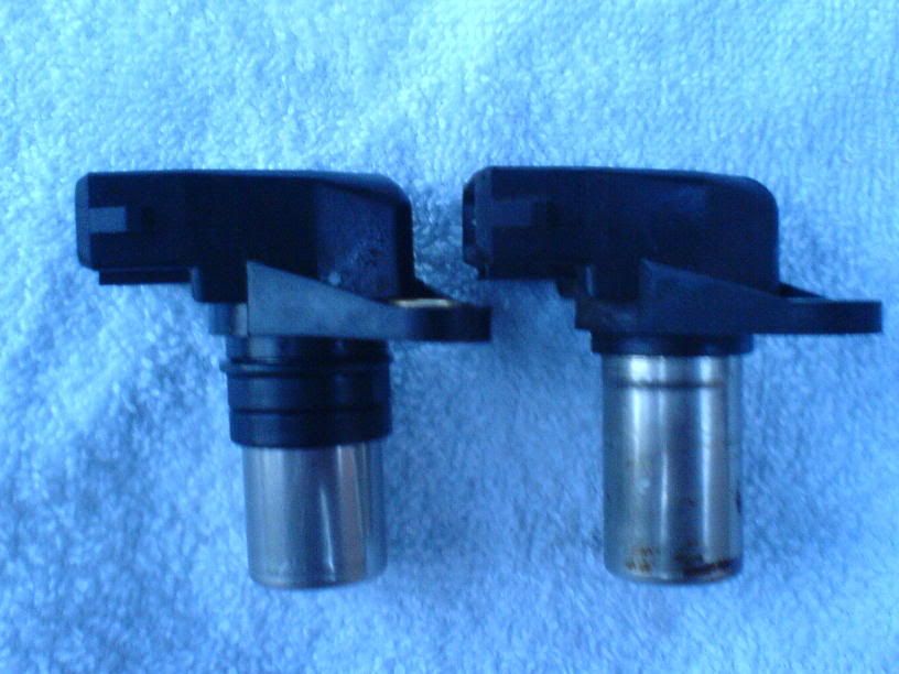

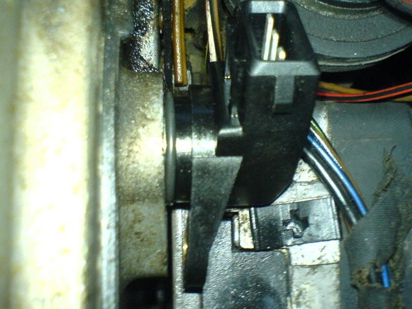

madscientist 0 Posted March 24, 2006 Right , i had another go at it last night after i had bought a proper plug lead removal lead. This is a pic of the new CPS on the left. (See rubber seal 3/4 way up) This is what it looked like in position and it was still running crap like that, It wouldnt push in at all, so in the end i just moved the seal out of the grove and it now sits flush with the head. Wow, Now i know why i bought a VR6 :D Full steam ahead :lol: Quote Share this post Link to post Share on other sites
KADVR6 0 Posted March 24, 2006 looks the same as mine that i changed last year, cant see why your having this problem, try taking it to the stealers, and see if they will have a look at it, heres a pic of mine so you can see the difference in my 2, but the new one went straight in, :? Quote Share this post Link to post Share on other sites
madscientist 0 Posted March 24, 2006 I dont fancy paying the stealers £50/hour or whatever they charge just to look at it? The seal did feal a bit loose tho, maybe the seal got hot and expanded before i pushed it in? Quote Share this post Link to post Share on other sites
KARMANN 0 Posted August 17, 2006 Where abouts is the CPS in the bay-its hard to tell from your second picture? Cheers Fraser Quote Share this post Link to post Share on other sites
Timo. 0 Posted August 17, 2006 right hand side of the head. Above the coilpack/dizzy Quote Share this post Link to post Share on other sites
KARMANN 0 Posted August 17, 2006 Thats where i thought it was,but couldnt see it-is it under the plastic engine cover? Cheers Fraser Quote Share this post Link to post Share on other sites
Timo. 0 Posted August 17, 2006 yes. you need to move the cover to really see it. Quote Share this post Link to post Share on other sites
KARMANN 0 Posted August 17, 2006 Top man-going out to do it justnow. Cheers Fraser Quote Share this post Link to post Share on other sites
KARMANN 0 Posted August 17, 2006 Na,cant find it at all.anyone point out to me where it is? Cheers Fraser Quote Share this post Link to post Share on other sites
Timo. 0 Posted August 17, 2006 its not very big mate. Its on the right side of the head, above the coil pack. You cant miss it! It has a 3/4 wire plug. Get the torch out. Quote Share this post Link to post Share on other sites
KARMANN 0 Posted August 17, 2006 had torch out removed engine cover etc. do i need to remove the distributor? Cheers Fraser Quote Share this post Link to post Share on other sites
Timo. 0 Posted August 17, 2006 MMmmmm.......... not sure. I have a coilpack amd its directly above it. Need to ask someone else mate. It maybe hidden inside the dizzy. T. Quote Share this post Link to post Share on other sites
