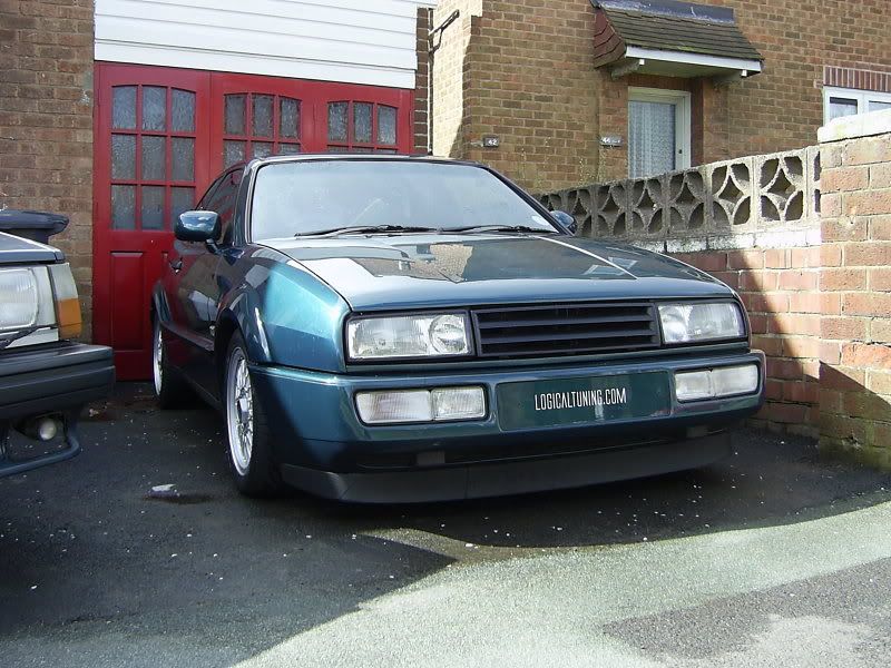

after giving the car a quick clean today, i decided its gotta look meaner, and i want to do this via spacing the rims out
has anyone spaced the standard rims? and if so by how much?!?!?!
i want the look of this
to be applied to mine!
without going mad on porsche or 9/10" wide rims i think this may set off the oem exterior look nicely
and can anyone recommend anywhere that can sell decent spacers?
