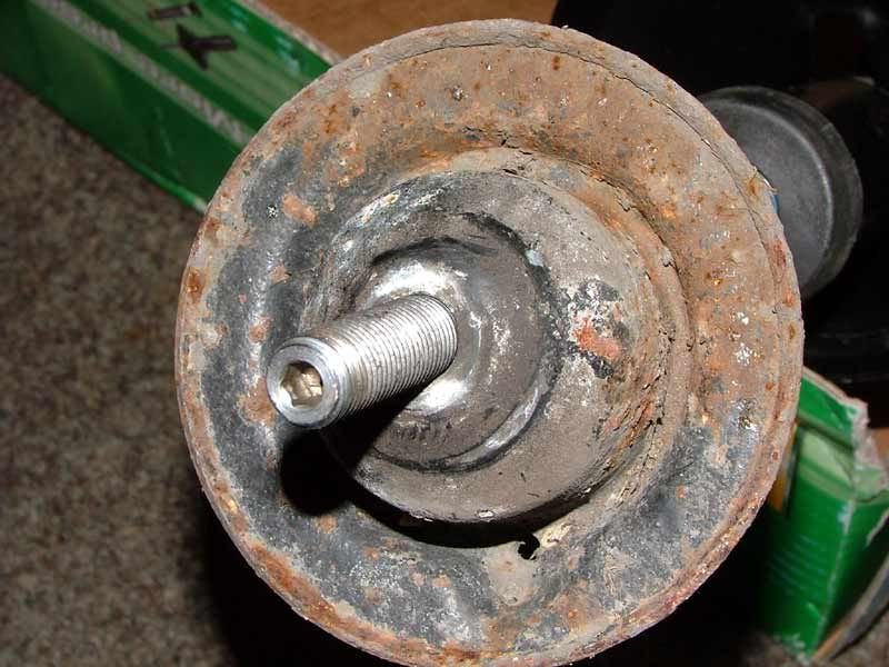

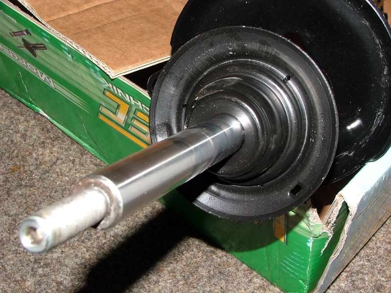

So I have VR6 sping plates seperate bearings n mounts. How do they fit??? Sorry to sound totally thick but I have done this job many times before on many different types of car, but i'm a little stumped.
The Original spring cap fits over ther threaded part of the strut rod and sits on the shoulder of the rod all very snug. When I tried the VR plate it just slipped over the shoulder of the rod and landed on the spring seat! :?:

Just stick it together in the picture as shown on the right on ETKA. Make sure you assemble it with the bump stop and boot to stop sh1t getting onto the fescallised portion(shinny bit of the damper)
Put the spring cap on and the bearing and then do it up with the nut until it locks off and then torque it up. Shove the rubber top mount over the top of it and poke it back up through the wheel arch, shove the top cap in from inside the engine bay and do the nut up - game over except for the bottom bolts and a 4 wheel alignment!
It will all fit so don't worry. (As long as the the spring cap retains the spring you are fine.)
becarefull, if it is not in contact with the top of the strut, then the strut will not be compressed when the spring is. Are you not missing some kind of washer>?

Did you get a nut ('threaded bush') from VW with each mount and bearing?? - if not then thats the part thats needed...
Dont fit the 'threaded bush' with the earlier larger spring discs - you should be fitting the nut.
