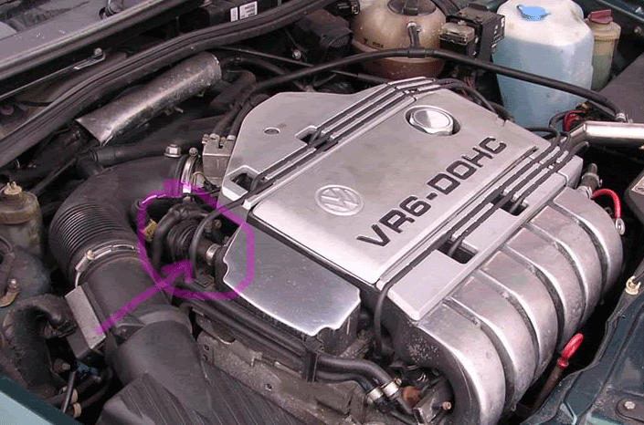

Socrates75 0 Posted April 21, 2006 I've highlighted in the pic a part that is split in two... (Ignore the HT lead) I'm not sure though if it is mean't to be like this or it has split (if so it's a perfect break) :? Many thanks Martin. Quote Share this post Link to post Share on other sites

Socrates75 0 Posted April 21, 2006 Mate it's the part behind the HT lead... Sorry, not very good on adobe :) Quote Share this post Link to post Share on other sites

steve @ 0 Posted April 21, 2006 Its the crank case breather which feeds back into the inlet. It shouldnt be split. You can remove it and use a small breather filter and block the other end going to the plastic inlet pipe. Quote Share this post Link to post Share on other sites
Socrates75 0 Posted April 21, 2006 It is split near the bigger bit left of the arrow, you can hear it sucking when the car is running... Will this be effecting my idle? Cheers. Quote Share this post Link to post Share on other sites
andy 0 Posted April 21, 2006 It won't do your idle any favours, as the break is after the MAF you are allowing unmetered air in. Quote Share this post Link to post Share on other sites
Socrates75 0 Posted April 21, 2006 Cheers! This "crank case breather", cheap part to replace or STEVE@ can you give a better description of how to remove/bypass :) Thanks Martin Quote Share this post Link to post Share on other sites
