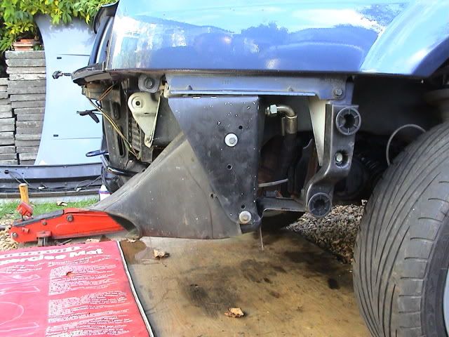

Topaz2008 0 Posted April 8, 2009 A 16 row 115 cooler can be mounted directly onto the slam panel in front of the charger and behind the upper grill. The mounting bracket holes of the mocal coolers line up exactly with two larger predrilled holes in the slam panel. Mount the cooler using 20mm washers at the top, benith the washers a 20mm dia x 2mm rubber washer, slam panel, then a 20mm dia x 10mm depth rubber washer, though cooler mounting holes, two 25mm M6 bolts though the centre secured by two nylock nuts at the bottom. Mount the sandwich plate as normal and run the short hose run to the cooler fittings which should face downwards toward the cross member. I hope all this makes sence. Mounting in this position provides easy access, no need to remove the bumper, but you will possibly need to remove the charger if you cannot do the fittings up with the front uper grill removed surficently tight enough. I have some picture somwhere i'll try and dig out. I have installed mine as shown below using existing holes in the slam panel with penny washers and stainless screws and of course rubber mounts between the cooler and the slam panel (as above really). The only thing that did cross my mind is the hot oil cooler near the super charger. I haven't put the rest of the car back together yet so would appreciate any comments/suggestions. I did check and the headlight just clears the cooler. Also other installs I have seen mount the cooler with the pipes upwards. This leaves a cooler full of dirty oil after each oil change :gag: At least this way the cooler has a chance to drain :D Quote Share this post Link to post Share on other sites
CTWG60 0 Posted April 8, 2009 Holy thread resurrection Batman! Won't you get an air lock though as air is lighter than oil! :shrug: Quote Share this post Link to post Share on other sites
Topaz2008 0 Posted April 8, 2009 Not sure :eek: it was advice from G-Werks so I have to assume its correct. I am sure I will find out when I start the car :) Quote Share this post Link to post Share on other sites
