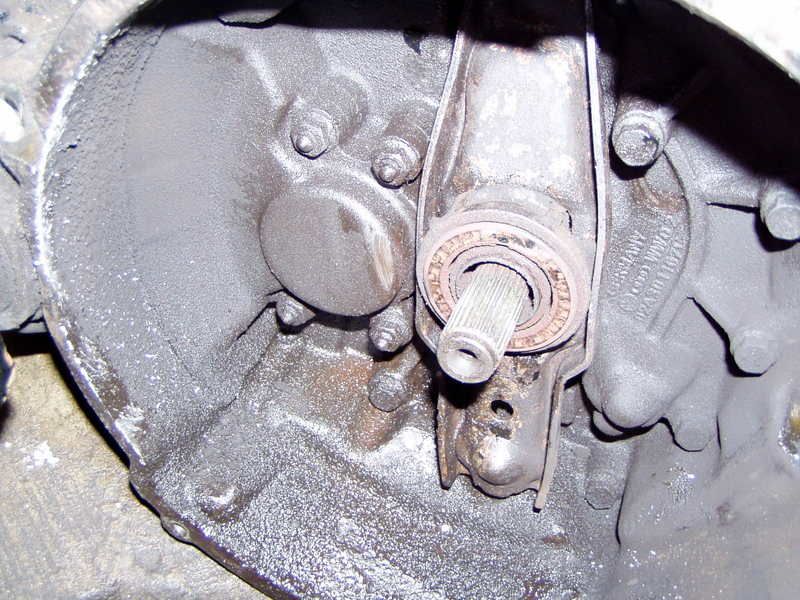

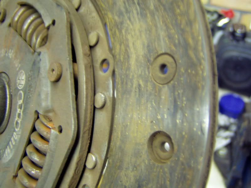

ziderapple 0 Posted March 12, 2007 I removed the gearbox today and noticed some scoring on it adjacent to the shaft - I've rubbed my finger over it, so its not too clear but it was fresh and clean before. Would a worn clutch cause the scoring?? And my friction plate. (not a great pic) Quote Share this post Link to post Share on other sites
CorradoVR6-Turbo 0 Posted March 12, 2007 Yes thats the pressure plate catching the bell when you have your foot off the clutch,its due to your worn clutch Chris,new one will sort that out. Quote Share this post Link to post Share on other sites

Supercharged 2 Posted March 12, 2007 Make sure you change that fork, it looks fooked and also the sleeve the release bearing moves along... Quote Share this post Link to post Share on other sites
ziderapple 0 Posted March 12, 2007 I've got a new clutch release arm to go on. Quote Share this post Link to post Share on other sites
