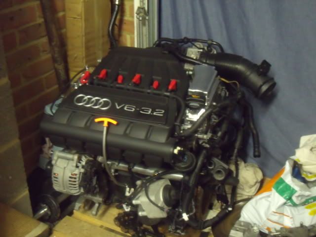

quicky1980 0 Posted February 7, 2010 forgot to mention that I got myself a aeromotive style FPR yesterday, so fueling issue should be under control now Here's the latest with the bracket fitted and the audi badge on Quote Share this post Link to post Share on other sites

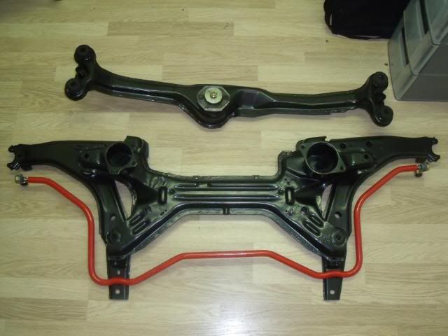

quicky1980 0 Posted February 16, 2010 What a busy few weeks. Managed to get most parts sandblasted and powder coated and I must say the results look very impressive. However, the subframe has some blemishes so will speak to the powder coaters tomorrow to see what they have to say about it. The loom is with South West In Car Technology in Bristol aka SWICT or Vag Doctors. It's being dealt with Mark, nice guy to talk to but seems a little dis-organised but I prob put it down to just being busy. Should get the loom back next week, Will be ordering the dubpower manifold at some point hopefully this week. Spending a little time to clean the spare VR gearbox ready for some detailing. Mised out on a corrado centre console gauge on ebay the other day :bad-words: was willing to pay good money for one as I really want one! Also having a bit of hassle with someone on here selling me faulty parts, still trying to get them to sort it out. So next jobs.... drive in the new VAG bushes on the subframes (once the sub frame has been fixed), fit brackets and exhaut manifold to engine then think Im almost there ? :cheers: Will be detailing the slam panel too, watch this space. Quote Share this post Link to post Share on other sites
