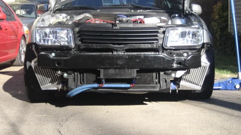

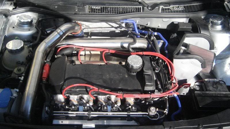

Just to clear things up on the whole boost comparison, I am not looking for advice of F/I or anything to do with F/I. I fully understand the potential. My second car is an HPA 12v VR-T Jetta(Bora to you guys.) Also I'm wanting to do the engine for short tracks, i.e. top of 3rd, to the top of 4th. I will need to be high up in the RPM's the a majority of the time due to the course configuration being as it has more footage of turns then straights. The 1/4 mile is only used for tuning purposes in my book. As to comparing the VR6 to an engine in the M3, I would say that yes, out of the box the VR6 feels unbeatable, but give it about .5 seconds and those dreams are toast. unfortunately our M3's come with different engines, at least my past e36 did hehehe, with a mere 240 at the crank. There are a ton of variables that should be taken into consideration, and I am very well aware of it. The bad thing is that I haven't gotten anywhere with this. So it's back to the drawing board to try and finish formulating my plan of attack for a purpose built car. Thanks for everyones help. I posted some pics for clicks of my Corrado, the Jetta, and my Old ///M3.
