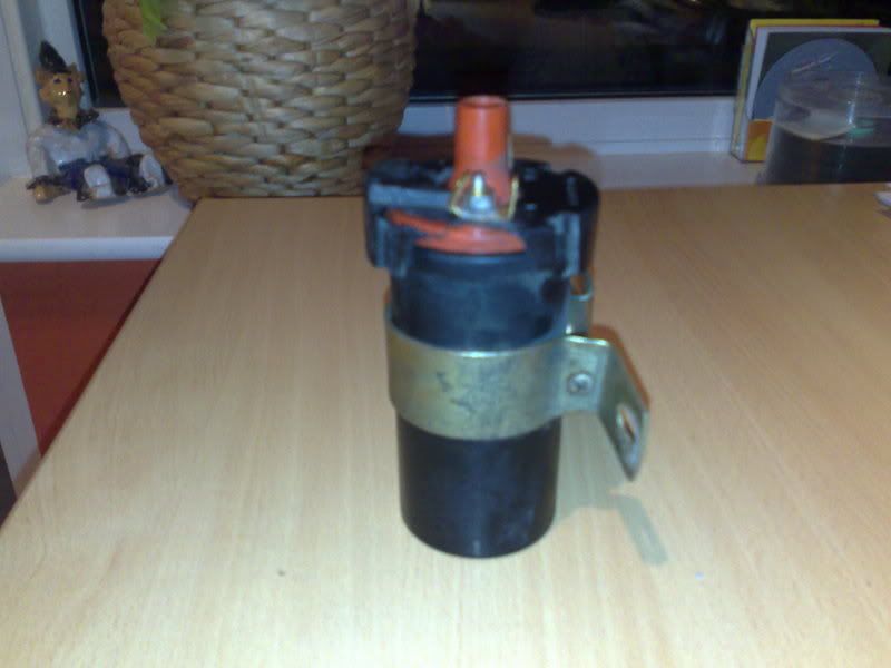

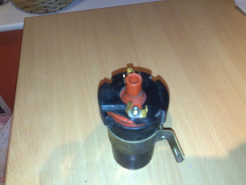

Rob_G60 0 Posted November 5, 2007 Hi all have a bit of a problem with my G60, the other week a snapped a bolt on the front engine mount which knocked my coil pack and the car cut out so we plugged it back in, but now the car revs funny, when i turn the car on it goes up to 2000rpm then dies down to about 1000 but goes up and down, i notice the coil pack has a crack in it would that cause this If not what could it be any help would be great cheers Rob Quote Share this post Link to post Share on other sites

Yandards 0 Posted November 15, 2007 Hi all have a bit of a problem with my G60, the other week a snapped a bolt on the front engine mount which knocked my coil pack and the car cut out so we plugged it back in, but now the car revs funny, when i turn the car on it goes up to 2000rpm then dies down to about 1000 but goes up and down, i notice the coil pack has a crack in it would that cause this If not what could it be any help would be great cheers Rob Er coil pack? G60s dont have a coil pack. Did you hit the ignition coil on the bulkhead? If so you will probably need a new ignition coil as this will effect the spark quality if it is damaged. Quote Share this post Link to post Share on other sites
Rob_G60 0 Posted November 15, 2007 thats the one (orange one) yeah when the engine mount snapped it got crushed and all plugs came off it to, Quote Share this post Link to post Share on other sites
Rob_G60 0 Posted November 15, 2007 Heres a pic of it Quote Share this post Link to post Share on other sites
Super-G 0 Posted November 15, 2007 I'd say that'll definitely need replacing. Should be back to running normally with it sorted. :D Quote Share this post Link to post Share on other sites

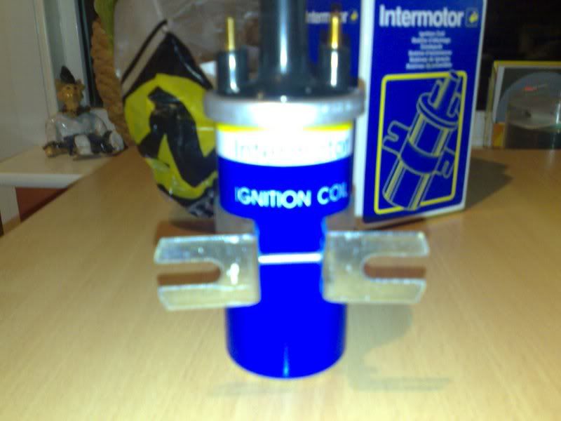

Rob_G60 0 Posted November 15, 2007 well mate of mine works down vw sorted me out £18 later Quote Share this post Link to post Share on other sites
