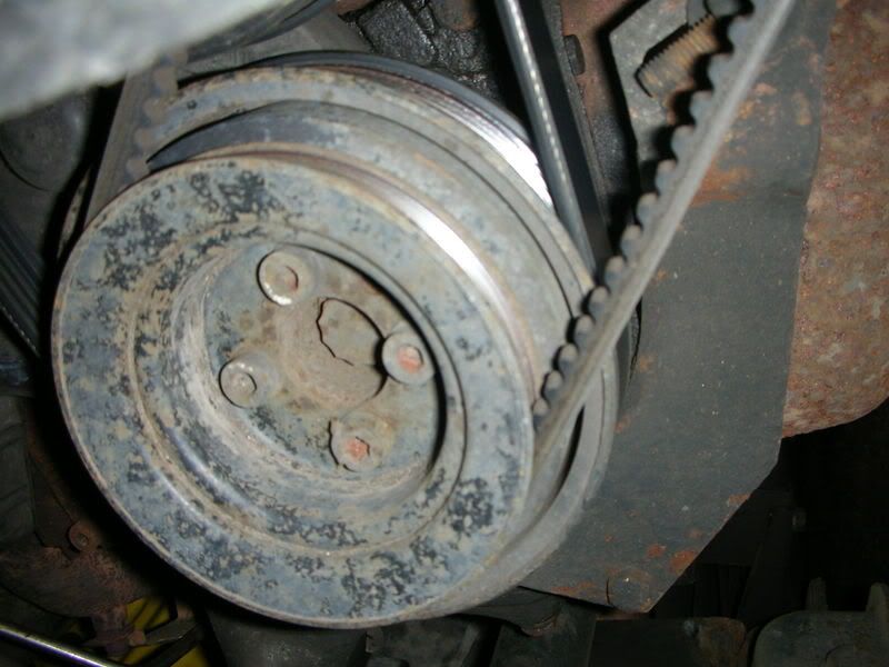

Having just bought a G60, I'm a little scared to use it at the moment, as I'm sure the crankshaft pulley bolt hasn't been replaced. I've purchased a new non-stretch one, as recommended, but am a little confused which bolt I should be replacing. Is it the centre bolt pictured below?

Best not to leave it too long boys... There is a long list of G60 owners who have found out the hard way
including myself (although mine worked loose rather than snapping thank god!!)
BTW before you do it get back to VW and get new crank+ water pump pully allen bolts.
As you can see from your pic they are not in the best nick and can be easily rounded
after 15 years of numpty mechanics abuse! They are dirt cheap and always in stock :-)
Well worth doing along with all your belts too! :-)
