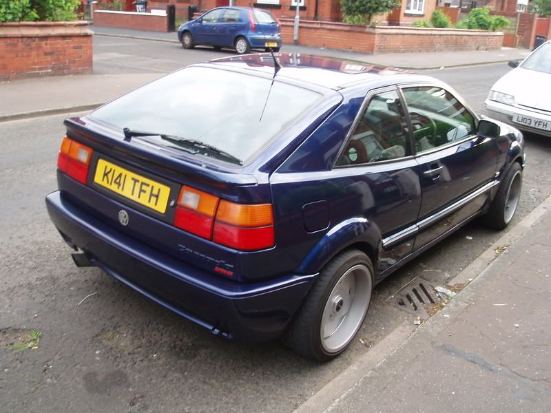

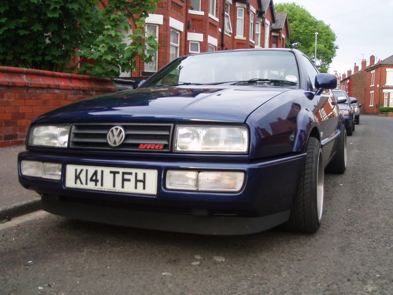

Been on the forum for a while, used to have a 2.0 16v that I repaired as a write-off. then sold that and recently got myself a nice Corrado VR6 (been after one for aaagggeess):
