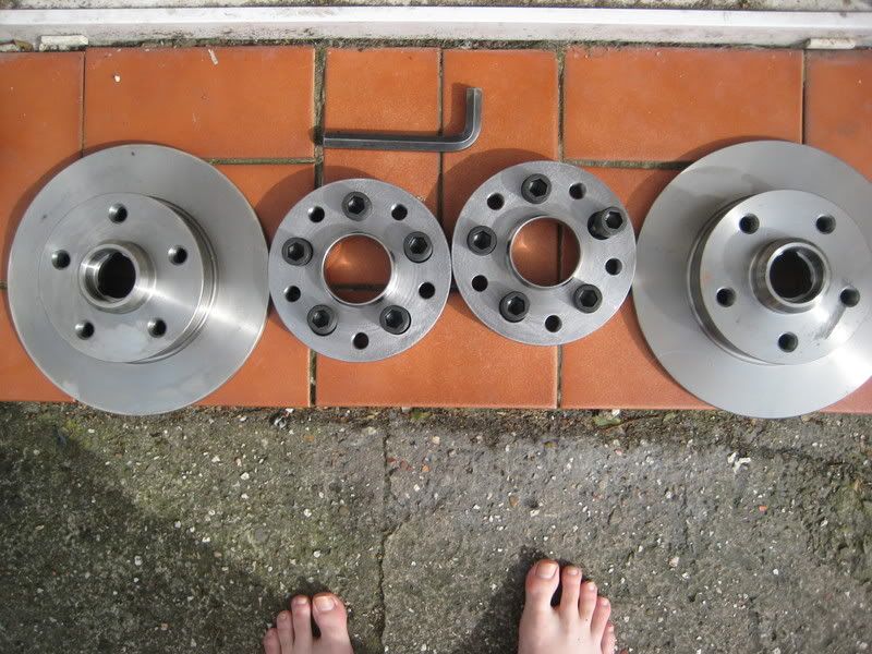

The easiest way to convert the dreaded 4x100>5x112 is to change the hubs and disks. But to save hassle I have changed the rear disks to VR6 (i.e. 5x100) and have these...
IMG_0585.jpg to fit.
and on the front I have a purchased 4x100>5x112 adapers from a belgium company called Concept...
