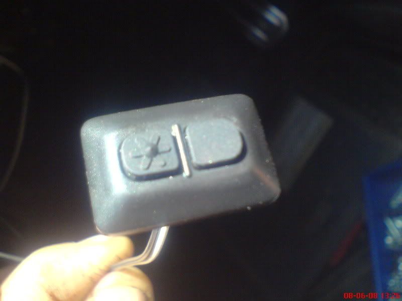

I also found a small switch under the steering column (see pic) Does anyone know what it might be for?? its about an inch long and has two wires going into a loom
