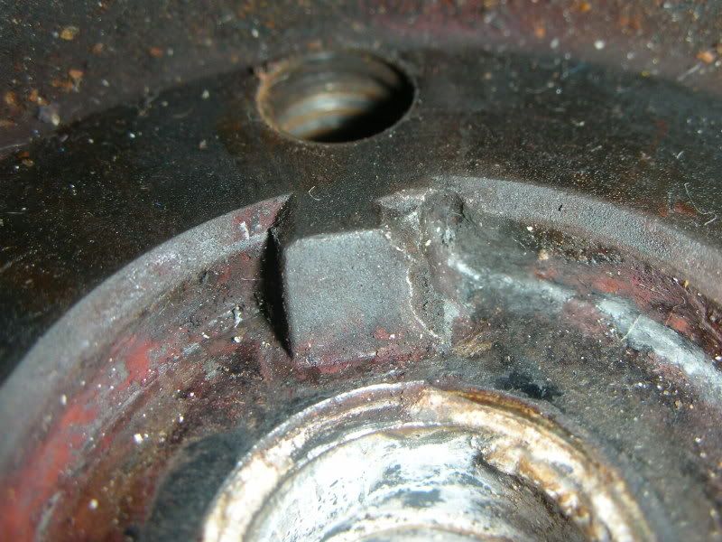

About a year ago, I replaced my crankshaft pulley bolt with a DX item, as I was unsure of the age of the stretch bolt in there. I did this without removing or moving the crankshaft pulley (something I wish I'd done now) and just carefully swapping the bolts over. Last week I noticed my flywheel TDC mark didn't line up with my lower timing mark on the supercharger pulley. I thought this was a bit weird and after doing some reseach, decided to removed the crankshaft pulley. Quite glad I did really, the key was totally battered on one side. The end of the crankshaft was also showing signs of where the pulley had once been loose and wobbled on the crankshaft. The keyway on the crankshaft had survived unscathed, so after refacing the crankshaft a new pulley, sourced from VW, was bolted on. I then replaced the timing belt and tension (even though they'd only done 10k :cuckoo: ), set the timing and idle up which is now rock solid at 850rpm.
Here's the key on the old pulley!
