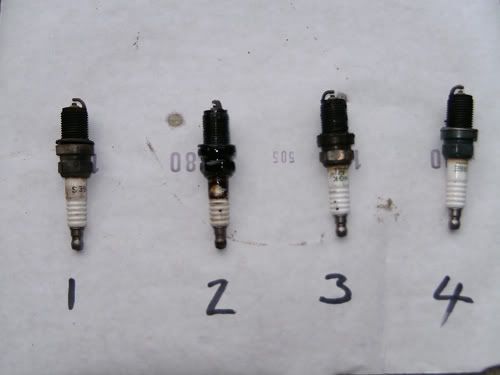

RallyRaddo 0 Posted January 4, 2009 Worst fears: HEAD GASKET :bad-words: Pulled the plugs out a short time ago, on looking into the cylinders with aid of trusty maglite, found: No 1. Damp with signs of condensation No 2. Toddlers swimming pool No 3. Olympic size swimming pool No 4. The North Sea Head gasket set from E-Bay £30 Next couple of weekends, head off, look for damage to pistons, fix as required, then Aberdeen Car Auctions or sell the serviceable bits of the car as parts. Hacked off ploughing money into this car. Thanks for the tips on this latest problem guys. Putting a pic of the plugs up just for the hell of it. Cheers Kev Quote Share this post Link to post Share on other sites
CorradoVR6-Turbo 0 Posted January 4, 2009 difficult to see the pics mate but does the plugs look steamed cleaned? Quote Share this post Link to post Share on other sites
RallyRaddo 0 Posted January 4, 2009 difficult to see the pics mate but does the plugs look steamed cleaned? Hard to tell actually. Plugs 1. 3 & 4 were I suppose, more of a grey powder colour, possibly from the water. No 2 was well oily. Out of 3 digital camera's in the house, not one was able to focus in, close enough to get a shot of the plugs, sorry. My missus has just told me that we WILL NOT be selling the Corrado or breaking it for parts! Think she's lost it if you want my opinion :cuckoo: Kev Quote Share this post Link to post Share on other sites
