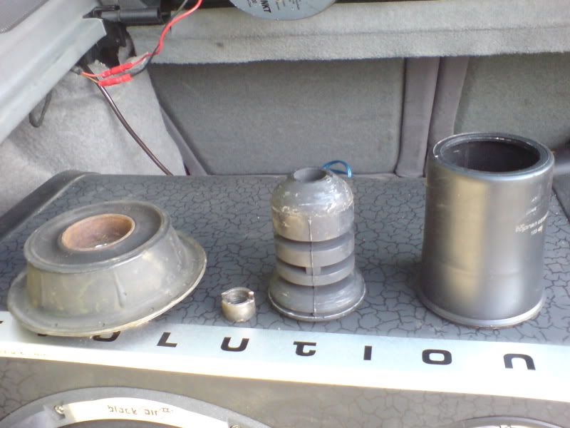

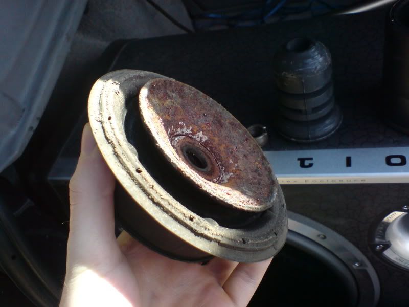

Had another look at what I've got with my top mounts.
Thats the old parts there btw. But don't think I have this donut shaped piece.
The way I have them just now is the coilover dampeners, then the bell shaped hat thing, then the top mount, held down with the notched ring, put onto the car, then the gold top then bolt.

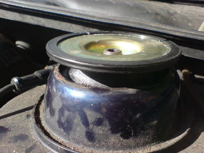

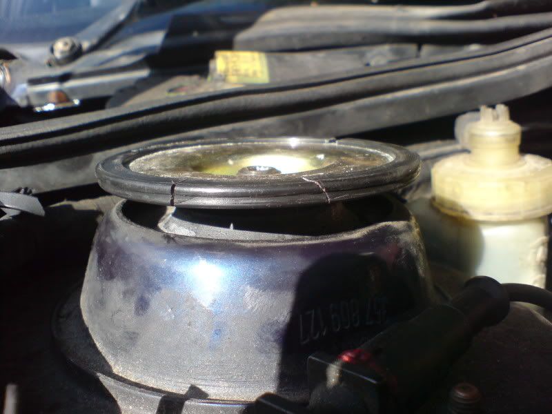

Heres a couple photo's of how they're sitting. First one is the one thats moving but I think the picture just makes it look like its sitting higher.
What a nightmare this is turning out to be. :censored:
Does the metal disc part come seperate to the rubber part? Looks like the mk2 top mount in the link you posted. You're best getting new rubber top mounts, top plates and bearings.
Pic attached -
top plate (in the engine bay)
parts under arch in order top to bottom -
top nut
Rubber top mount
bearing
top spring plate (not needed)
bellows
bump stop
Nah the metal disc doesn't come apart from the rubber. And both the current top mount and the old ones are the same?

Hey there, I've noticed it's the same with mine. The pics you have there are identical to how mine sit. I went out and bought new rubber top mounts, but the plate that you bolt on from the engine side still sits high. So if you jack the car up and take the weight off the wheel, you see the rubber mount drops slightly, and the weight is all then held on the metal plate. I was uncertain, but having checked with a local vw specialist, they have assured me this is correct?! Having worked on other cars it would usually be held tight in the strut, but it would asppear it isn't the case here? Hope this helps.
They are standard 'early' (or Mk2) topmounts. The bearing is fitted into the mount itself, so you don't need to worry about that.
That mount will sit directly ontop of the coilover top plate. You don't need the original top plate that sat ontop of the original springs!
