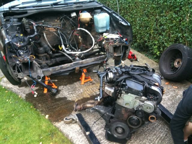

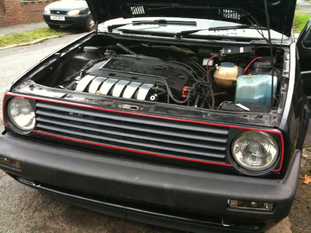

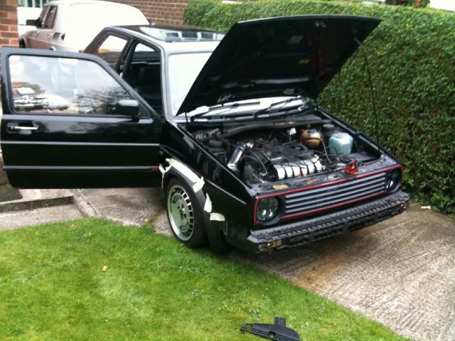

joeshaw123 0 Posted October 30, 2009 So theoretically I can get it mapped without the diagnostics port? Yeah the plan was that I would get all the work done, cams in and 6 branch on with all new bits, then get a map, so I can just enjoy driving the balls off it! I've got a rado 2.9 block thats getting some love to replace the old smokey 2.8 And as for a couple of pics: Quote Share this post Link to post Share on other sites
