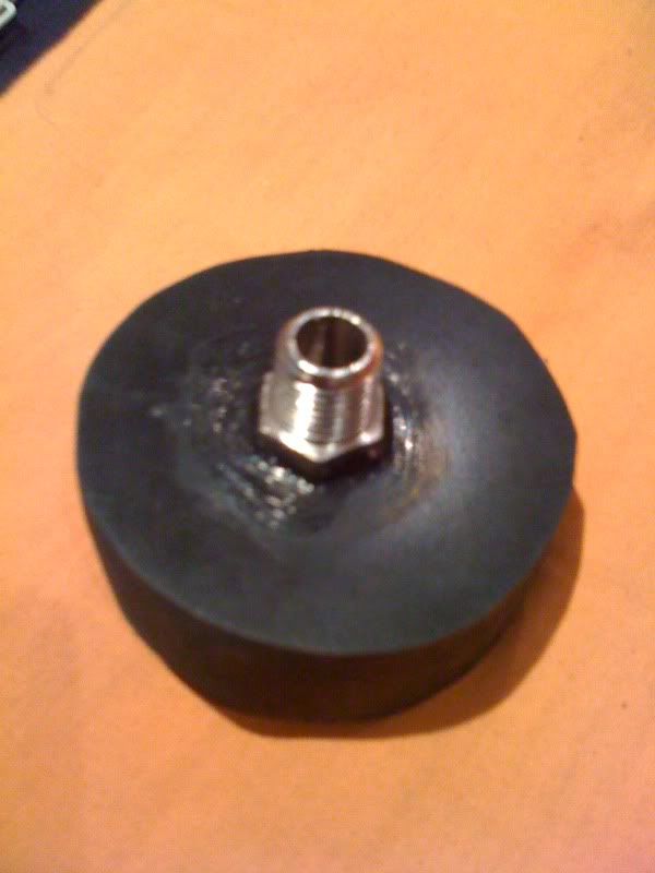

1 hockey puck,1 airline fitting,1 m8 nut1 washer,1 silicone pipe,silicone sealant

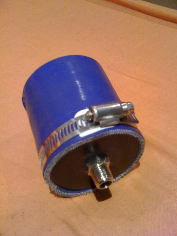

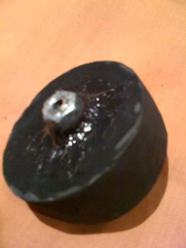

To start with i had to take about 5mm off the diameter of the hockey puck so that it would fit in the silicone pipe.  I then drilled a hole through the centre slightly smaller than the airline fitting.  I then hammered the airline fitting through - quite a tight fit. I made a thread onto the other side of this so i could put a washer and nut on it.  This is to make sure the fitting doesnt come out under extreme pressure. Finally i sealed up the joins with silicone sealant just to make sure it was air tight. Job done! heres a few pics
Once it was all together i removed the boost pipe nearest to the turbo outlet and clamped this in its place. I used an airline to link this to my compressor and set the output pressure to around 20 psi (my turbo is supposed to spike at 18 psi). As soon as i opened the tap i heard many leaks including the stupid whistle i originally heard. spent around 15 mins locating and rectifying the leaks. Sorted!
