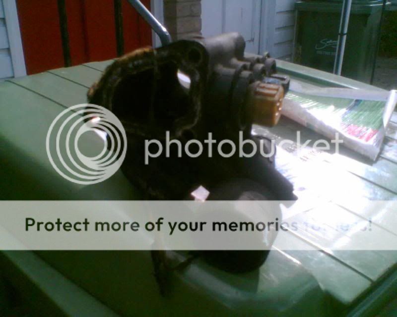

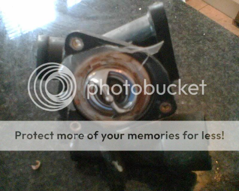

ok well I managed to eventually get the thermostat housing out..... the seal rings around the edges have completely worn away (you can see the bit of the rubber dangling down in the pic!) which will hopefully explain the reason I am losing coolant fingers crossed!
The seal around the plastic that holds the thermostat itself has also withered away so will need replacing

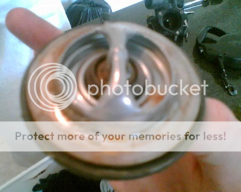

I popped the thermostat itself into a pan of boiling water and it opened and closed ok, so guess it should be ok, but the rubbery seal around the top of it is looking a bit battered (not sure if you can make it out properly in the pic below - its a bit of a manky brown colour) - can i buy this seperately or do I need a new thermostat??
