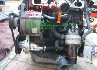

Thanks for that link mate its very useful and makes it alot easier for me to understand what goes where and what does what. I'm gonna keep the k-jet and tidy it up, its going to mv developments to be setup on the rollers next friday and have any small wiring issues sorted. Then i will extend/shorten/clean and tuck the loom. Before cleaning and painting the engine parts crackle black. One small thing someone could tidy up though, see diagram below?
I appreciate the lettering is a tad on the micro size so i'll translate:
" My car has a short elephant trunk like pipe here, where should this pipe go? I assume its a breather for something as when the car is running condensation comes out of it"
"Which of these three is the water temp sender for the ecu and the instrumentation"
Also the thermocouple/switch thing that resides in the bottom of the rado radiator, should that have 2 or 3 wires going to the plug?

From what i can remember the red crankcase vent plumbs into the airbox? (maybe wrong and no longer have my valver so cant go and check!)
