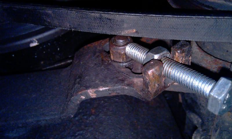

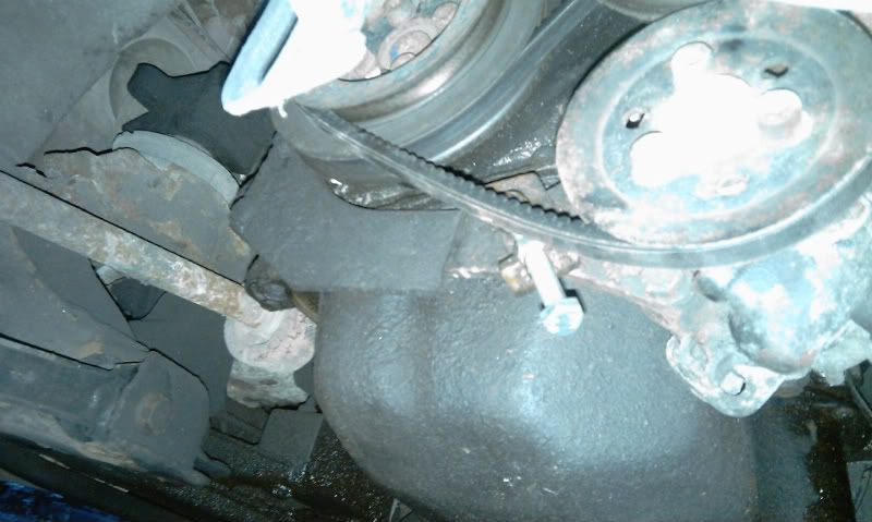

So i got under the car last night to sort out the power steering.. I thought just the tensioner bolt was loose...
It wasn't there!!! lol Also the tensioner bolt couldn't go into a nice bolt due to the fact the wrong bolt was used previously..
I took a pic to illustrate! The silver bolt is what is missing and how I assume the car used to run.. before the bolt fell out!
