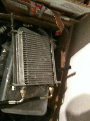

poll250 0 Posted April 23, 2010 I've got a 25-row mocal cooler with my Rotrex kit from Rob, everythings new except the cooler. Now, I'm thinking that a 25row cooler is a touch overkill when the standard one that comes with the kit is only 10 row. Here's my mammoth 25-row: My plan is to buy this : http://cgi.ebay.co.uk/ws/eBayISAPI.dll? ... Track=true and use it with my Rotrex, and then use the 25 row Mocal to cool the engine oil. My question is: This kit comes with a sandwhich plate, does it look like the correct thermostatic one to mate the the VR oil lines, or do I need something different / extra? Thanks, Quote Share this post Link to post Share on other sites
KADVR6 0 Posted April 23, 2010 personally just use a 12row cooler for the rotrex, and the same for the engine oil. Quote Share this post Link to post Share on other sites

Kevin Bacon 5 Posted May 5, 2010 Yeah you only need a 13 x 235mm cooler at most for the engine. A 25 Row will massively over cool the oil and you'll end up with excessive oil pressure. Aim for 92-100 cruising oil temp, which the 13 row will achieve :D Defo agreed with Mr Whipped Bananas, I would retain the OE heat exchanger. 0 to 70 oil heating is massively faster, then it flows out to the Mocal. As we all know, nearly all engine wear occurs during warm up, so that oil needs to get hot fast! :D Quote Share this post Link to post Share on other sites
